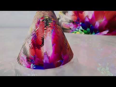

    sounds rather like parallax which I have been trying to do in various softwares with different levels of success
    not tried it in DAZ yet, the video is Twinmotion and the Twinmotion material nodes datasmith imported then duplicated in Unreal Engine where I investigated it further
    is using a type of displacement but it doesn't displace in 3D rather the image moves from camera or viewport position according to a depth map like those depth map Facebook images

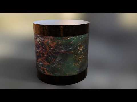

    do you have these?
    https://www.daz3d.com/pl-semi-precious-iray-shaders
    maybe with translucency and refraction bumped up could work with geoshells, I am playing with them now
    I found refraction at 50% lets some show through, second one has 2 geoshells and three shaders offset -1 and -2
    it probably could be subtler
    the video looks like stuff in a jar devil
    the ends are a tarnished metal shader by Jenny Greenless meant to contrast the effect
    video
    1920 x 1080 - 2M
    1920 x 1080 - 2M
  • richardandtracyrichardandtracy Posts: 8,029
    edited December 2021
    I don't have that set, and wasn't even aware of it. Good spot, thank you very much and it's now wishlisted. It's close to Christmas, and my wallet is somewhat empty.. Maybe next month. Your video is showing some of the effects seen but not all. The pearlescence can appear to change reflection angle across the cylinder as it turns. If you imagine the reflection occurs at 30 degrees to the camera, at some points it'll be reflecting from the correct position on the outside of the cylinder, then you'll get a flash of reflection somewhere else, as if there is a surface at 30 degrees to the camera within the material that is reflecting back to the camera. As the cylinder rotates further, the reflection can move faster or slower than the cylinder, as if the apparent internal surface has its own contours unrelated to the cylinder surface. It's a really hard thing to describe, but is really attractive. And strangely it was more common in the 1930's when celluloid was more commonly available. Regards, Richard.
