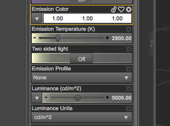

    :-) I have a question about the new Iray reander engine.
    I can't seem to get light to show up in my renders upon rendering, all my renders come out with this black overlay.
    What am I doing wrong?

    First, use Photometric lights, Spot or Point.
    Second, if you are doing an indoor scene, you need light, a lot of light. For the photometric lights, use the light settings at the bottom. And you can also turn any surface into a light using the IRay emission shader.
    Crank up the Luminous Values, 100000 is not extreme in any way.

    What is in your scene and, if it has environment, is it enclosed? Use the photometric lights, under the Create menu, in lieu of DS lights. You can even make a plane an emitter. You can set to Sun/Sky in the Render settings, but only if the scene is not enclosed, as I mentioned. Then you will likely need the photometric lights or mesh lights (meshes that have been made emitters with the emissive shader.
    Make sure you have downloaded the Iray Beta Content (it's listed on the first page of the DS Beta Release thread. General Shaders are then in Shader Presets under Iray Uber Defaults. Under each of G2F and G2M in their materials folders, is a skin shader to apply over your figure's textures. If your DS Beta was in DIM, the Iray content will be too; place Iray in the search field of DIM.

    :-) The scene is an outdoor scene, I tried using the photometric lights, but still had the dark overlay. So I finally did a test render with one of the interactive lessons, strangely the interactive lesson rendered just fine. But I am going to try some of the suggestions I got earlier out too.
    I am using genesis base model for my out door scene, and I saw in syckleyields youtube on getting started in Iray that she converted a lot of her materials to Iray. I haven't figured out how to do that for all my things yet but the ones I did manage to convert to Iray uber surface still don't render. I am going to try the idea of making other surfaces in to a light and hope that makes a difference.
    :question: My biggest problem though is that none of my lights register to the system Iray lights regular lights they just don't show up the only light that does show up is the headlamp on my camera.

    For outdoor, use the Environment under Render settings.
