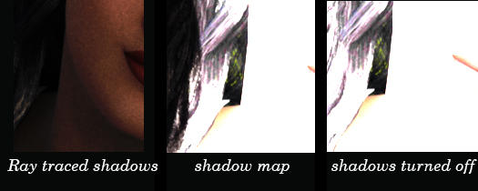

In my scene, I have a single spotlight.
I had it set to Shadow Map while I positioned it and did tests, planning to change to ray traced when I was ready for real renders.
When I swithch it to Ray traced...the spotlight doesn't work...doesn't make shadows..doesn't make light.
If it's in shadow map, there's light and shadows. If it's set to no shadows, there's light.
In the screenshot below, the spotlight is set to 2000%. This is just for demonstration purposes.
I shut the program and restarted, but that didn't fix it.
I have NOT tried just replacing the light. I'd rather know what's happening than just get around it.
Any suggestions?

    Where is the light, in relation to items in the scene? I don't know, but ti would seem possible that if it's very close to a wall it might be blocked by ray-tracing but that the combination of bias and the granularity of the mapped shadows might let the light skip past the wall.

    Richard had it nailed.
    I have a Node Instance of a wall between the spotlight and the ...everything else.
    "Cast Shadows" is set to off and the other modes of the light ignore it and pass through, but ray traced doesn't.
    turning the node to vis off, and it works like it should!
