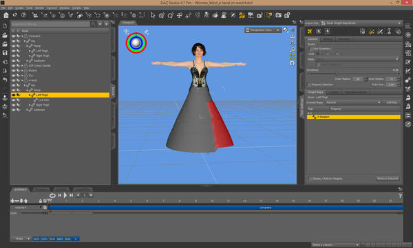

    I cant't tell how glad I am to meet you SickleYield, only this morning I ran your "Saving Gen 4 Custom Bones on Conversion" tutorial with great success. I know your capacity.
    If you look at my first image you see that I have deleted everything except X Rotation. Then I made an Select All and Fill Selected (with 0).
    And still a red area is left where does it come from? And in the next image I have deleted even the X Rotation -then I started the animation and the bones still affect the mesh even with all weight maps deleted!
    Also I am very curious of what is Scale Weights it isn't explained anywhere. A search on the forum get no hits. Truly peculiar IMO.
    Perhaps I shall explain what I am trying to do. The simple skirt shall serve as scaffolding for a ball gown to be simulated in Marvelous Designer. That is the reason for that the original movements for "Knee Length" dress is to much, I want a more subtle movement.

    It's showing red in your image, which would mean it's still painted. Did you select faces before you did the fill with 0%?
  • vintorixvintorix Posts: 220
    edited March 2015
    I have tried both, First "Select All" then "Select Faces" (belonging to lThigh).
    Still, if I delete X Rotation it goes away, But then as I previously explained the mesh is still affected! ;)
