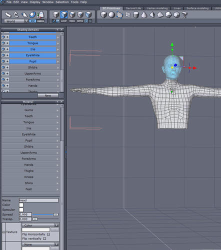

    Thanks for the helpful comments. I took some time to look things over more closely, look for related tutorials etc. I am still not quite clear on some things/need additional pointers. So I will try to be more specific.
    I open this low-poly figure in DAZ. I want to use the arms/chest as part of another figure so I take it into Hexagon and cut off the parts I don't want. I then send it directly back to DAZ (i.e. as opposed to exporting it as an obj file) . . . it looks just like this in DAZ only the posing nodes are gone . . . i.e. no way to "bend" and "twist" the forearms etc. Is there any way to preserve or restore the posing nodes of the revised figure? Thanks again for any pointers towards relevant tutorials/threads etc.
    871 x 986 - 206K
  • RoygeeRoygee Posts: 2,247
    The short answer is no:)
    Once you delete something from the original figure, you destroy everything about it that makes it a figure - rigging, UV mapping, textures, morphs and you are left with only a mesh.
    One method to achieve what I think you want to do is to export it as an .obj, do the surgery in Hexagon, build (or cut up another figure) to get the other parts, join them then go through the whole process of UV mapping, texturing, and rigging.
    The other method is to use two figures, morph them without damaging them, make parts of each invisible and match them together. There is a lot more to this method, but that is the basics. Over the years, many Minotaurs and Mermaids have been made this way - you could probably find some examples for free at ShareCG to study.
