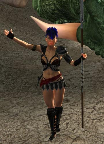

Working on a piece, and look alright, except the character's mouth appears to glow when rendering.
An ideas or suggestions would be appreciated. Attached is the problem area of the render.
504 x 699 - 81K
  • KhoryKhory Posts: 3,854
    That is due to SSS being turned on for surfaces inside the mouth. Logical if your going to have the mouth open or parted but for a closed mouth render not necessary at all. Either way there are two solutions. 1 is to make sure that all lights used in the scene have shadows turned on. 2 turn off the SSS inside the mouth for all those surfaces. Some characters come with a sss inside mouth option. If not you need to go to the surface tab with the character selected. Click the default templates. when that opens select template 4 as it will select all the inner mouth surfaces at once. Go down to subsurface off-on and slide it from 1.0 to 0.
  • Richard HaseltineRichard Haseltine Posts: 112,059
    Having lights not set to cast shadows can also be a factor.
  • SkyshorrSkyshorr Posts: 28
    Hi folks, I have noticed the mouth glow when I have applied the 'Interjection.' product.
  • aueienaueien Posts: 4
    Had to try a combination of all of your suggestions, and finally it's gone. Thanks everyone.
