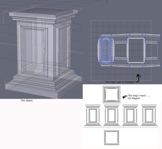

I find UV mapping in Hexagon anything but straightforward. For example, this box-like object. The UV map I get with Hexagon is obviously messed up . . . I tried all sorts of things to get it right (I have worked through multiple tutorials etc) . . . finally I just gave up and took the obj into UV Mapper (i.e. a different UV mapping program) . . . that took just a couple of clicks to get the map I wanted (below).
The point is . . . I did the polygon-related work on the object in Hexagon, that went quite well. But when it comes to mapping . . . clicking on various boxes and gizmos doesn't really seem to get me anywhere, at least not in a predictable, straightforward way. For one thing, it seems Hexagon just sort of gives up on complex tasks with larger files. Or maybe that's just my lack of experience (I've only been working with it a few months). Suggestions?

To get to the specifics of your model - if those blue lines I see on it are the seams, it is no wonder it didn't work out - they are cut in all the wrong places for a good unwrap.
It appears you have done a cubic (or box) projection in UV Mapper - if you did the same in Hex, you would get pretty much the same result. Neither result would work well for texturing - the frames around the panels need to be separated and unwrapped flat and this could only be done by a full unwrap, rater than a projection unwrap.

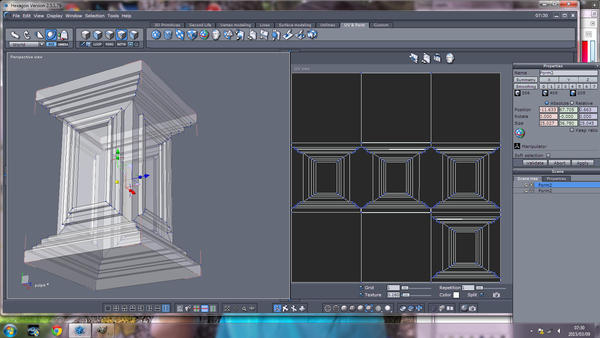

To put my money where my mouth is - made a rough copy of your model and mapped it in Hex - one using cubic mapping (black background), the other unfolding with seams :)

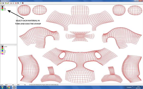

I have been using UV-Viwer since Patience recommended it in another post.
http://d3d.sesseler.de/index.php?software=other&product=uv_viewer
Very simple to use and I prefer it to UV-Mapper Classic.
