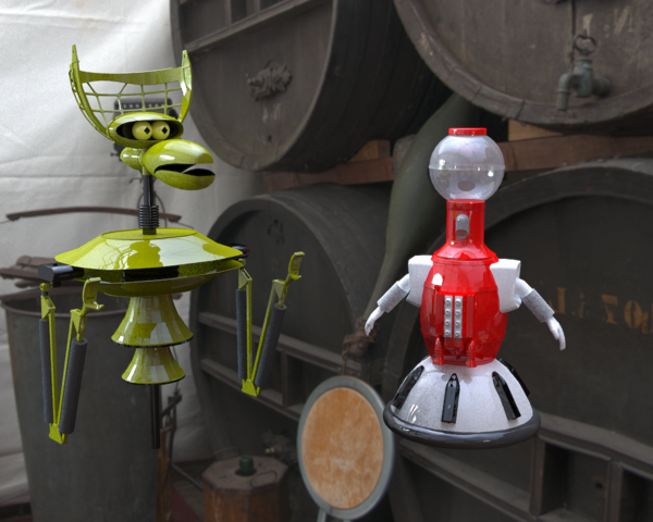

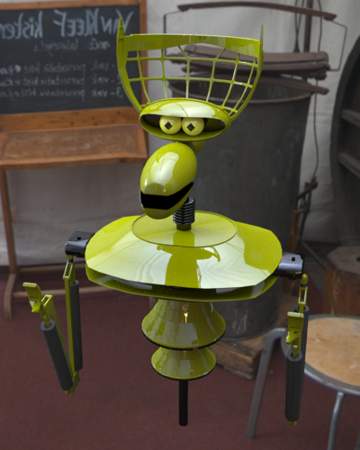

    Even worse...the mtl specifies just Kd...straight up colors!
    It shouldn't even blink when loading them, but it doesn't load them in DS or about half the other ones I tried...Blender, yes, but that saves out blanks. Wings3D...nope, MisfitModel...nope, K3d...haven't tried. PropViewer3.2...yes, but saves out blanks. Don't have Hex installed, currently...
    Doing the colors manually and saving him out in DS works perfectly...
