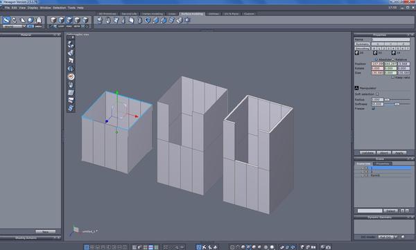

Started with a cube primitive, removed the top, added a bunch of polygons to make clean cuts out of the front/back. (the image has many more than intended, but was an attempt to fix the issue)
http://i.imgur.com/yV9z2dD.gif
Then Applied the Thicken. Ive used this technique several times successfully, but today it's going bonkers.... I now have a porcupine and not a box.
http://i.imgur.com/2WBlW3Y.gif
This happened. I closed the program, started over, had it do it again. Any Ideas as to what's happening?
Looks to me like some of the vertices are not getting selected before you do the thicken (this can sometimes happen you split edges and not all of the verts in a edge split)

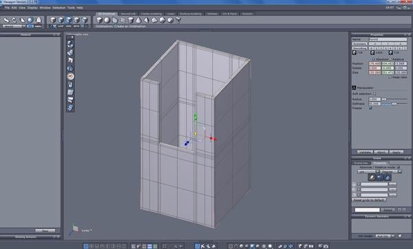

I think you started with the wrong cube (second life cube). A quick an easy way to do it is to start with a simple 3D Primitive cube.
1. Delete the top face.
2. Add tessellations as shown.
3. Select top edges and Extrude up.
4. Add thickness.
5. Add more tessellations to keep the shape (Pic2).
