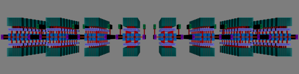

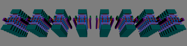

    My other thought, a guess, is the demand on the graphics card when moving around a scene with that item in it. I still don't know why, things are fine with five figures and cloths, tho a dozen single sided cubes brings the view-field to it's knees???
    case and point, this 3D diagram never got finished, lol. It's just a mountain of primitive cubes, and 16-sided cylinders.

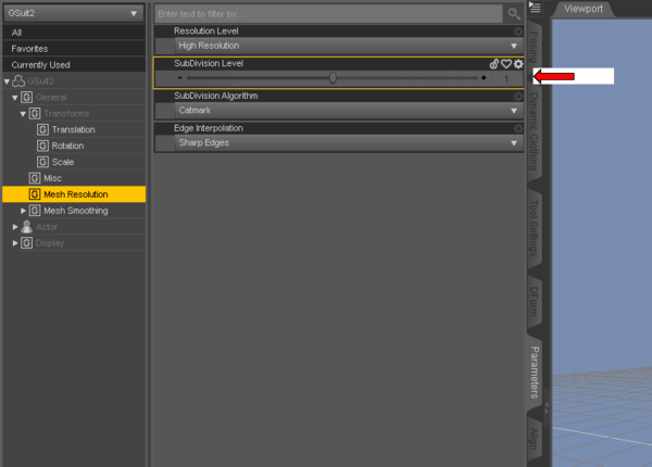

    My apologies, I had assumed a similar functionality between the two things (shaping HD dials, vs Sub Division Level). I have few things that let the setting go to 2, and I don't think I have any that go to 3 on that setting (I'm glad for that). They all default to '1', so I'm mostly good to go. It's just the HD figures that cause me most grief.
    If the mats are good, a setting of '1' seams to be good for most things, except extreme close ups. I have never needed to set the Gsuit2 to anything other then the default '1'.
    This dial?
    806 x 577 - 24K
  • ben98120000ben98120000 Posts: 469
    Besides affecting exports, subdivision level in parameters tab is just for preview. You may set it to 0 if / when you have bunch of subdivided stuff in the scene and your viewport response becomes sluggish and it will still render with "full" subdivision (so long as resolution level is set to high).
