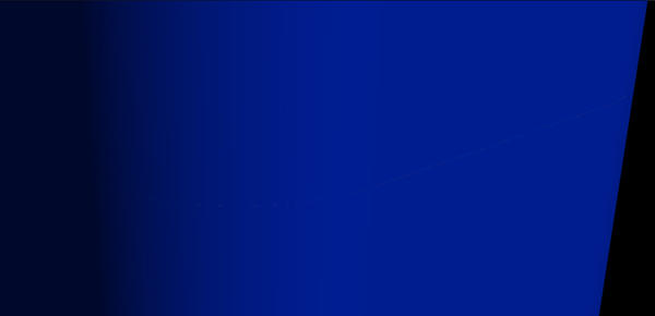

Can anyone please help? Attached is a render showing a simple spline object in Carara 8.5 with a shader applied that uses two cylindrically wrapped rectangular layers positioned on the model at precisely 50% each. However where the seams join in the middle of the object, there appears a faint line of overlapped pixels from the top and bottom colours. Does anyone know why this is happening?

    Thanks for your replys - here is a close up on the same model. I will also post this onto the Carrara Discussion forum.

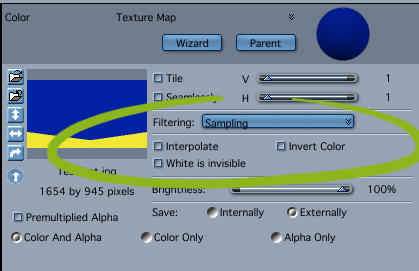

    Thank you for looking into this but we have solved the issue! Using the highlighted section of the shader settings, it appears the Filtering and interpolate boxes need to be switched to Smapling and unchecked to give the crispest results. There still appears to be a very faint seam but it is much better and we can work with this.
