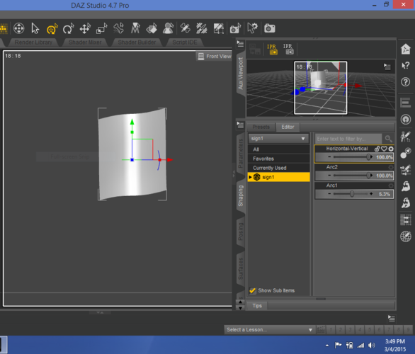

Hello. Made a very simple flat rectangular prop with a little thickness and three morphs, passing it back and forth from Daz Studio and Hex. (Starting up again after being away for 3 years, so relearning things).

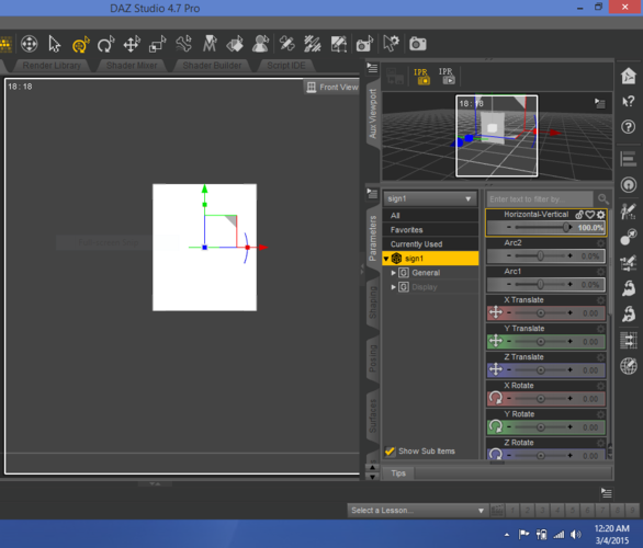

One of the morphs is simply a Horizontal-Vertical morph, rotating the prop on the Z axis. The other two make the flat prop concave/convex.

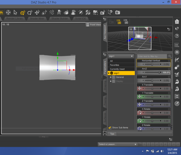

The morphs work ok individually, but the mesh warps when the Horiz-Vertical morph is used with either of the others.
The baffling thing is that the problem does not occur if the prop is turned in Daz Studio using the rotation tool or slider instead of the morph made in Hex.

As far as I can tell, it seems that the morphs are somehow "reading" each other and don't know how to essentially ignore that the other morphs are active, thus causing the distortion. Sadly, I don't have a solution, because as I said, I have been out of the scene for a long time (several years in fact).

Bear in mind that morphing is essentially changing positions of verts and the change happens linearly. The changed verts go from one position to another in a direct line, not in an arc, so using them for rotating things like animated opening doors simply doesn't work. If you wanted to something like I think you do, you would have to make dozens of morphs, each with a very small change and apply them sequentially.
