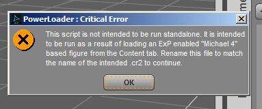

    Its not working, even though the .dsb file is sitting right next to the .cr2 file in its folder; it simply does not see the .cr2 file its supposed to support. Per the Error message I'm getting. It seems pretty clear that while the installer is telling me its successfully initializing the figure, its not; is there a link/procedure available for initializing a figure by hand; as I have uninstalled/reinstalled several time now; and the .bat (for want of a better word.) Is just not getting the job done; even though it thinks it is.
    383 x 160 - 13K
  • fixmypcmikefixmypcmike Posts: 19,718
    If you are seeing the .dsb and not the .cr2 then it sounds like your content folders are not set up correctly -- DAZ Studio should show the .cr2 with a scroll symbol in the upper left corner instead of showing the .dsb. What is the full path to the files, e.g. "C:\Users\Public\Documents\My DAZ 3D Library\Runtime\Libraries\Character\DAZ People\Michael 4.cr2"?

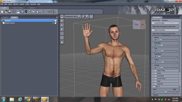

    The installers install where the user tells them to. Visual proof that Michael 4 works in DS 3, he has a bit of body builder and Hiro 4 morphs to prove the morphs work also.
    1366 x 768 - 174K
    What about all the error messages ... mostly about not finding the files for the aged folk. I realize i don't post a billion things to prove everything I say but if the program cannot find a file that D/S4 can find, then the file is there and D/S3 for whatever reason can't find it. I have downloaded some fresh installers for the aged morphs and one day when there's more time may install them and see what happens. In the meantime in response to the OPs question, yes, some of the older install thingies do not work as well they used to, be it because of updated information for the D/S files conflicting with ancient file information and thusly confusing poor D/S3 or be it because the OS with whatever updates it has received, no longer being able to handle things like that initializer. I'm not a coder to figure out why the initializer isn't initializing.
