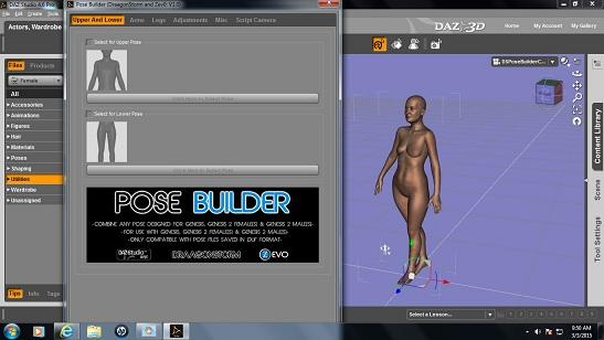

    Since it is a script, it can't be docked. You can see, by my image, how much room the screen takes up in my program. You can't make the window less wide, but I can make less high by dragging on the bottom corner. When you use "Click here to select pose", that window may also be large, but you should also be able to drag on the corner to diminish it's size. That said, I am on a Mac as opposed to Windows, but I would hope they work similarly.
    Does your script window come in much larger than mine?

    My screen resolution is set to landscape but it shows up as portrait.
    Heres what my screen looks like. I can only move PB down or sideways. I cant move it up enough or minimize it to even reach the bottom corner, although that might work if i can get to it.

    If, as may be the case on a laptop, you are limited to 768 pixels try clicking on the last visible option - I can't read it as you have shrunk the image, which isn't necessary as the forum will do it for you and we can then click for full-size - to select it, then click again to deselect it so that it as you want it but leave the focus there, then press the tab key (once, I'm told, works, but you may need to experiment) to move the focus to the Accept button and finally press the space-bar to click the button.
  • edited December 1969
    My screen was already at its smallest. Adjusting to portait turns everything sideways so i can see what's there but wasn't able to resize or shrink anything down but using the tabs and enter buttons worked! It's at least workable for me now so that's the important thing. Thanks everyone for the help and advice. Much appreciated!
