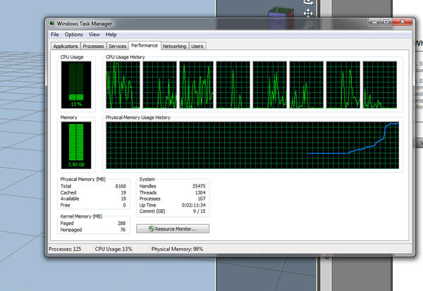

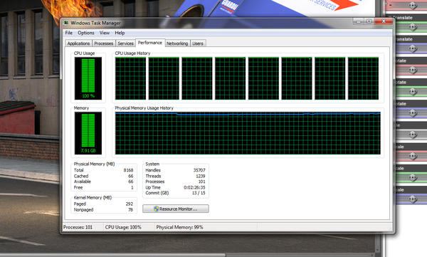

    So here is a quick test I did using a very large scene, with Urban Sprawl 2, 3 supervillains, a superhero main character, and some high-quality vehicles. It is very slow editing. I rendered this scene at 2000x3200 or so because it is a full page spread for my webcomic. I chose this scene to tax the PC during the test.
    To load the scene, I was at 7.98 GB RAM used, high CPU on 1-2 cores (total CPU usage was ~15-20%, RAM near 100%) - first pic below.
    Once the scene was loaded, the PC was running at 6-7 GB used, 10% or so CPU.
    Upon starting to render... while "Optimizing", CPU use was around 60^, RAM at 7 GB+. Took ~ 4 min to optimize.
    While rendering the image (using progressive render), I was at 7.75-7.99 GB, 90+% CPU on all cores, often pegged at full RAM, full CPU (generally the resource monitor was reporting 0 RAM free, a few hundred cached). Took ~10 min to render after optimization (14 min total). - second pic
    After the render, we dropped down to 4.5 GB, <5% CPU, and stayed that way.</p>
    After DAZ shutdown, even though < 3 GB was in use and < 5% CPU, the computer still froze for 3+ minutes (mouse could be moved, but no responses to clicking, or HIGHLY delayed response, i.e. double-click the Photoshop icon but wait 3 minutes for PS to start up). The computer acts for all the world like it is RAM locked, but the system is not reporting a RAM shortage. Which is very odd.
    At any rate, I think there is no question that my current system is both RAM and CPU limited.

  • HavosHavos Posts: 5,711
    I also have 8GB in my box, and for work reasons I typically have a number of apps continously running which needed 2GB or so between them. I find the best way to handle scenes with multiple characters is to convert them to props once I am certain I do not need to change the pose again. This massively reduces the memory needs of a typically Genesis 1/2 figure, and when rendering the additional memory needed for this is also not so much.
  • Steven-VSteven-V Posts: 727
    Hm, that is an interesting idea. I had not considered converting them like that.
    But in terms of the test, some folks had asked if I was maxing out memory or not and clearly I am.
