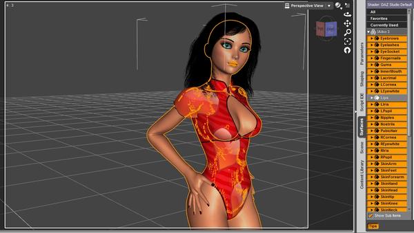

easily adaptable script to select a list of surface materials
mCasualmCasual Posts: 4,607
edited November 2015 in Freebies
following a special request
for users that are not afraid to open a script in notepad.
the script shown here
change the list of material names to suit your needs
save this script under a name like
"AikoHeadScalpMatSelect.dsa"
then select Aiko, run the script, bam, the listed materials are selected
the same code in DSA format can be downloaded here
https://sites.google.com/site/mcasualsdazscripts5/mcjselectthesemats
var matNames = [  "SkinHead",  "SkinScalp" ];var DSVersion = new Number( App.versionString );var skel = Scene.getPrimarySelection();//we'll detect users attempting to apply this script to the wrong figurevar bFoundSomeMatches = false; if( skel ){ if( skel.inherits( "DzBone" ) ) {  skel = skel.getSkeleton(); } if( skel.inherits( "DzSkeleton" ) ) {  var nodelist;  if( DSVersion >= 4.0 )  {   //with D|S version 4 and up,    //the skeleton owns the DzObject      //the DzObject owns the shape   //the shape owns all the figure's materials   nodelist = [skel];   }  else  {   //with D|S version 1, 2, 3   //each bone owns a DzObject   //each DzObject owns a shape   //each shape owns some or all the figure's materials   nodelist = skel.getAllBones()  }  var nNodes = nodelist.length;  for( var i = 0; i < nNodes; i++ )  {   var obj = nodelist[ i ].getObject();   var shp = obj.getCurrentShape();   var nMats = shp.getNumMaterials();   for( var j = 0; j < nMats; j++ )   {    var mat = shp.getMaterial( j );    if( matNames.find( mat.name ) >= 0 )    {     bFoundSomeMatches = true;     mat.select( true );    }   }  }  if( !bFoundSomeMatches )  {    MessageBox.information(      "This script was designed\n"     +" for a different figure than\n"     +" the one you selected.",      "Problem",      "&OK;"     );} } else {  MessageBox.information( "Please select a figure.", "Problem", "&OK;" ); }}else{  MessageBox.information( "Please select a figure.", "Problem", "&OK;" );}

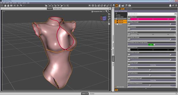

    there seems to be a DS4 thing going on
    if your current tool is the surface selection tool
    and you select the clothing item's root node
    and you select 1 material
    run script shown below
    you do-see on-screen that the surface selection gets indeed toggled
    BUT if you look in the surfaces tab, you can see the selection is still that 1 initial material
    ... still studying the problem
    var DSVersion = new Number( App.versionString );var skel = Scene.getPrimarySelection();//we&#39;ll detect users attempting to apply this script to the wrong figureif( skel ){ if( skel.inherits( &quot;DzBone&quot; ) ) {  skel = skel.getSkeleton(); } var nodelist; if( skel.inherits( &quot;DzSkeleton&quot; ) ) {  if( DSVersion &gt;= 4.0 )  {   //with version 4.0 and up,    //the skeleton owns the DzObject      //the DzObject owns the shape   //the shape owns all the figure&#39;s materials   nodelist = [skel];   } else  {   //with version 1, 2, 3   //each bone owns a DzObject   //each DzObject owns a shape   //each shape owns some or all the material figures   nodelist = skel.getAllBones()  }  var nNodes = nodelist.length;  for( var i = 0; i &lt; nNodes; i++ )  {   var obj = nodelist[ i ].getObject();   var shp = obj.getCurrentShape();   var nMats = shp.getNumMaterials();   for( var j = 0; j &lt; nMats; j++ )   {    var mat = shp.getMaterial( j );    var sel = mat.isSelected();    mat.select( !sel );   }  } } else {  MessageBox.information( &quot;Please select a figure.&quot;, &quot;Problem&quot;, &quot;&amp;OK;&quot; ); }} else {  MessageBox.information( &quot;Please select a figure.&quot;, &quot;Problem&quot;, &quot;&amp;OK;&quot; ); }
