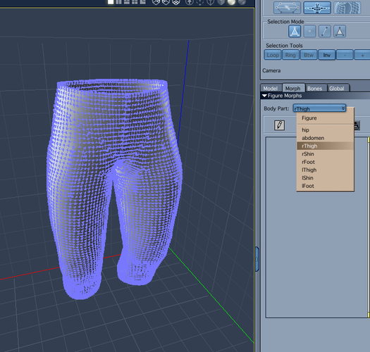

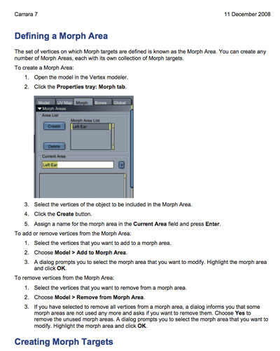

I am stumped as to how to create a morph area on an item that does not already have a morph area. I have read the manual but the information does not agree with what I am getting on my screen. When I press the drop down menu for the Morph area list and select a body area..nothing happens. Also I do not get the buttons "Create" or "Delete" as shown in the manual. If the item of clothing already has a morph assigned - no problem..I just hit the + and it works fine - but how do you create a morph from scratch ?

    I have tried that and every variation I can think of. Whats odd is that the pall does not match that shown in the online manual.

    I did not check my typing. I meant to say that the morph panel does not match the panel shown in the online manual.

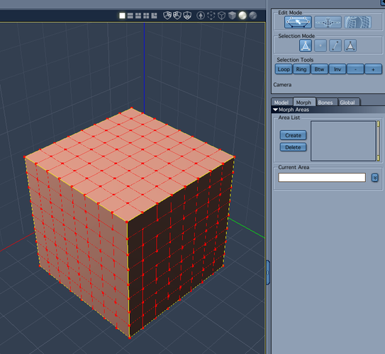

    This is stranger and stranger. When I put a vertex primitive into the scene I can bring up the correct morph panel with the options of create and delete. But this does not happen when the breeches mesh is used. Is it protected in some manner ?
