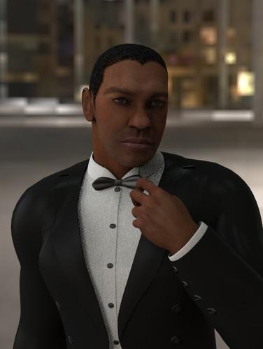

    A question to clarify.
    I wish to take the head of a model, let us use david 3 for example.
    I wish to increase the resolution so that the preexisting maps will have greater resolution.
    The result will be used in Key Shot.
    Poor example attached
    455 x 605 - 99K
  • Richard HaseltineRichard Haseltine Posts: 111,650
    Ah, you mean using polypaint. Well, in that case I see no benefit in dividing in DS - you are just increasing the amount of data you need to move around. I'd also advise using OBJ export and then in ZBrush Preferences>Import Export>Import turn off the import of Polygroups and turn on Import Map as groups - that will reduce the number of parts when applying textures. It may be worth while, in DS, using the Geometry Edit tool to consolidate the surfaces that use the same maps. I haven't bought the Keyshot bridge or renderer so I can't give you advice on that, though I do wonder if you can't apply the textures as normal images to surfaces in that rather than having to go through polypaint.
