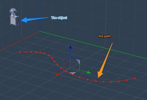

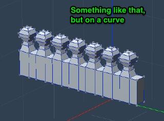

Hi,
sorry, but I do not remember how to follow a path with an object to make something like a zipper for example.

  • dot_batdot_bat Posts: 373
    are you thinking of 'copy on support'? tool is in hexagon, no tool in carrara i believe
  • JamyJamy Posts: 192
    Thank you,
    Indeed, I had seen this tool somewhere in Hexagon .........
    No other solution with Carrara? :(
    i dont think there is anyway in carrara to do the copy on support, 95 % sure. if you have hex why not do it there?

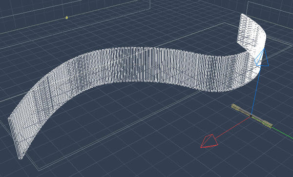

  • stem_athomestem_athome Posts: 526
    edited February 2015
    I think the closest you will get in Carrara, is to extrude your path into a thin surface, then use the "Surface replicator".
    The main downfall is that the distribution along the path cannot be controlled well for what you want. As the spacing options are "Minimal / average", and not an absolute / incremental distance.
    Added material zones along path to force distribution to be even, and that appears to work OK (well, for this quick attempt).
