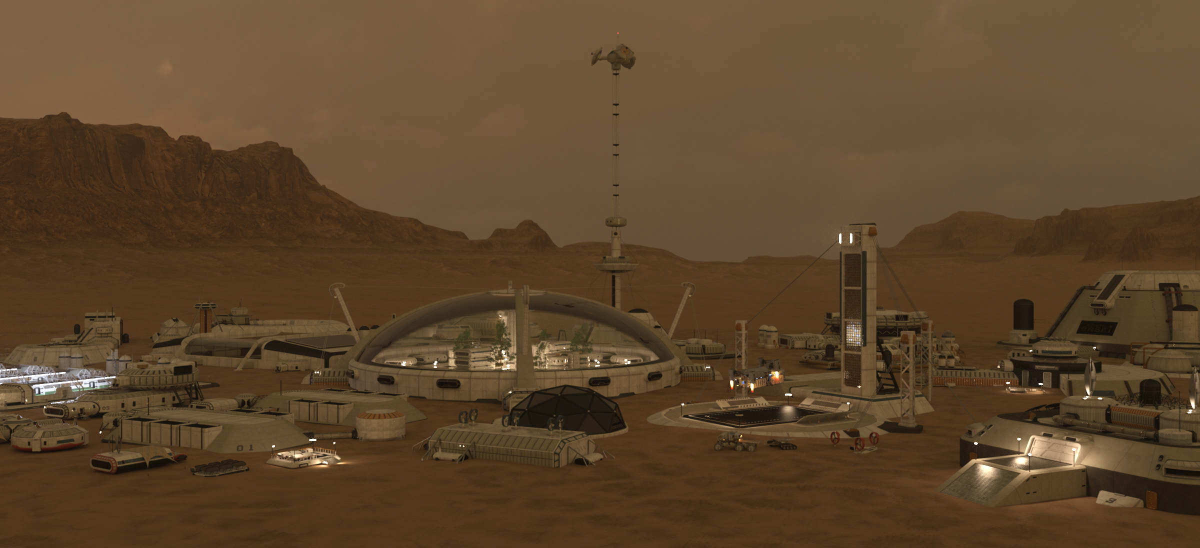

    I have a bunch of the Kitbash3D kits and I think they are awesome. I posted my workflow here: https://www.daz3d.com/forums/discussion/comment/6715041/#Comment_6715041
    Here are a couple of DS Iray examples:

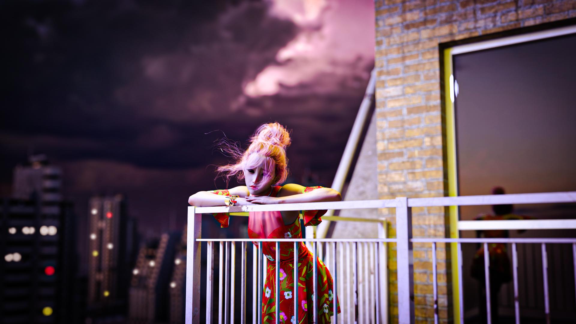

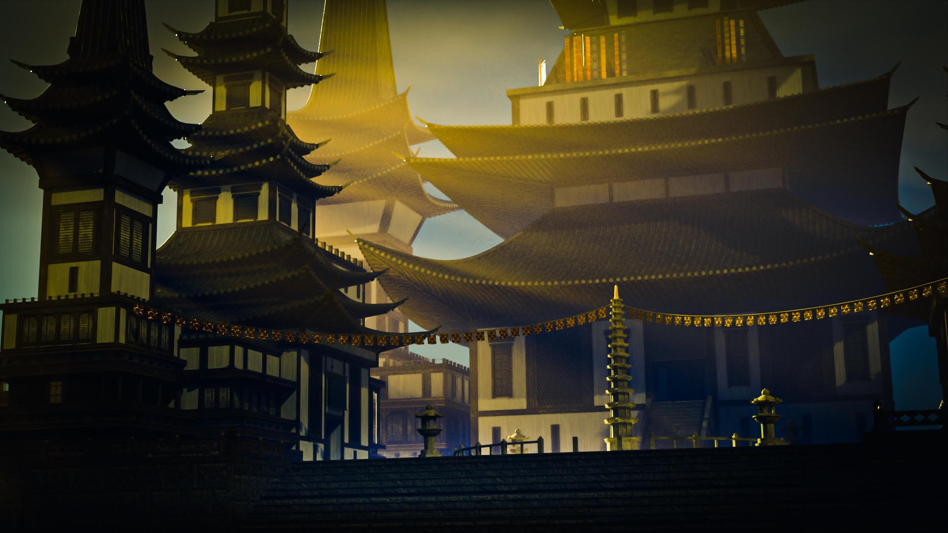

    I've messaged Kitbash multiple times, commented on their Facebook posts and ads and once they sent me a survey about features requested and I always tell them to make it compatible with Daz, they just don't realize there's a userbase here who would want to utilize their sets. So maybe if more people email them they'll start to take note.
    The easiest way to get them into Daz is to set the scene up in Blender how you want the buildings, unless you want to export each building by itself and place everything in Daz, I find this way much quicker. Then export the scene as an OBJ and bring it into Daz, I set the import scale 8734% (I'm sure there's a way to get proper scaling right from Blender but I don't know what it is and this method works perfect for me as the buildings are scale to Daz characters). And then I highlight everything in the surface tab and set to the Iray Ubershader. Then you go through and you link the materials from the Kitbash textures, or whatever textures you like. I usually use stuff from Quixel Megascans instead. This does take ten, fifteen minutes once you get in the groove, but then all you have to do is save it as a material subset and save that to your kitbash 3d folder for the kit itself and you never have to do it again, you just apply the material setting to your obj next time you bring something in from that kit, unless of course you want to change something.
    These are two renders I did with the Soviet Blocks set and the Shangri-La set a month ago or so. I think the one on the balcony, those are Quixel textures for the bricks, but the buildings in the back were from Kitbash.
    1920 x 1080 - 1M
    1920 x 1080 - 1M
    Post edited by benniewoodell on
  • GalaxyGalaxy Posts: 562
    The girl image is now my new wallpaper.
    That's awesome and really cool, I'm glad you liked it :)

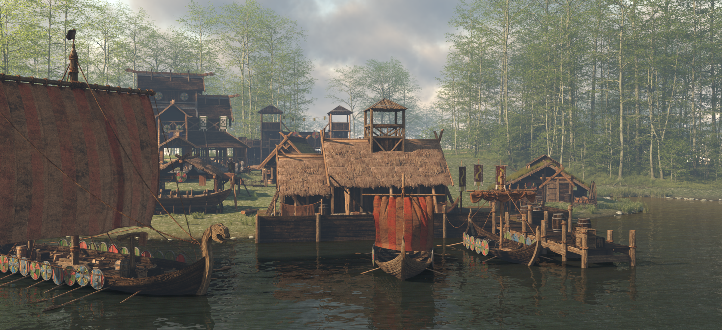

    Here is one sort of final-ish image with the valhalla set. This took about 10 minutes of material tweaking after loading the models that I converted via my workflow linked in the second message in this thread.
    Terrain is done with Ultra Scenery.

  • evacynevacyn Posts: 993
    Ciao
    TD
    Great work - did you use UItraScenery for the trees/backdrop?
  • thd777thd777 Posts: 946
    edited November 2021
    Yes, indeed.  The Pacific Northwest pack and also C66 Ultra Scenery Toolbox to make space for the houses and flatten the ground where needed.

    To me it seems like the Valhalla assets aren't blending in that well with the UltraScenery assets. When I saw your image in the other thread I was actually kinda disappointed at the time, as I had purchased the Valhalla kit and hadn't done anything with it yet and was worried that the quality didn't appear to hold up. But it's probably the surface settings that are bugging me. I know some folks are pickier about that stuff...thinking some of them might need to be darkened a bit.

    I know the Vikings reached parts of Eastern Canada, but it would have taken a lot of sailing for them to have reached the Pacific North West :-)

  • MelissaGT said:
    Ciao
    TD
    i have the Valhalla set and when I tested it, it looked just like the promo page on kitbash's site, so it's probably a tweaking of the surfaces thing.
