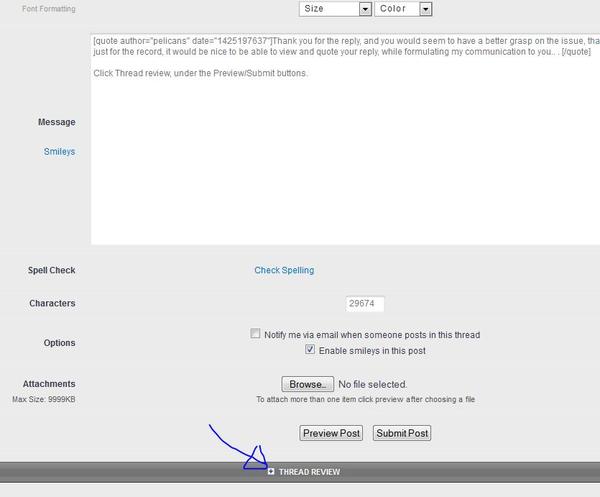

  • Richard HaseltineRichard Haseltine Posts: 111,315
    pelicans said:
    Thank you for the reply, and you would seem to have a better grasp on the issue, than I. And just for the record, it would be nice to be able to view and quote your reply, while formulating my communication to you.. .
    Click Thread review, under the Preview/Submit buttons.
    835 x 691 - 52K
  • pelicanspelicans Posts: 10
    Thank you Richard, I have to feel that this should be the default, rather than an option, as most would miss it as I did.

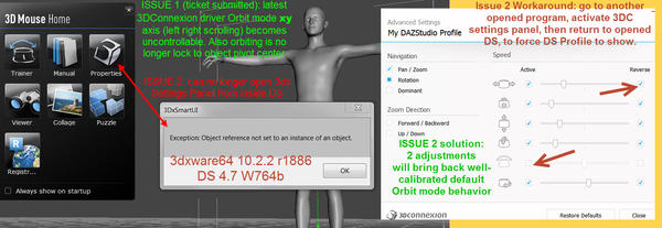

  • MythmakerMythmaker Posts: 606
    Hi fellow 3Dconnexion users
    Not sure if this applies for DS 4.8 or 32bit, but if someone has similar issue I have, no harm comparing notes.
    I've been using 3D mouse spacenavigator since 4.5.1.6 and it worked out of the box on my W764bit setup. I use the Orbit mode, sensitivity level and calibration is fine for me...banking is turned off, very intuitive decision. Good job overall. Cuts down the pain of super-clicky DS workflow. A tremendous help.
    After DS 4.7 and very recent 3Dconnexion 3dxware64 10.2.2 driver, I could no longer pan in XY axis/ left right scroll. Orbiting objects also has wobbly pivot lock. When trying to calibrate DS's 3DC profile settings, an error pop-up shows up instead. Loss of access to 3DC profile settings panel calibrate means I can't fix the panning issues. Zendesk ticket submitted a few weeks ago.
    I reverted to a very old 3DC driver version 3.16.3 which worked with DS but not with many other 3DC-compatible apps. Today I reintalled 10.2.2.. Same 10.2.2 DS behavior persists. Then I found the solutions.
    I'm having fun again in DS. Happy. It's hard to go back to no 3D mouse once you have a taste of it. I dream the day Carrara gets 3D mouse support too.
    So dear geniuses of Daz3D dev, please be sweet and kind and bestow upon long suffering Carrarists the super wrist savior of native 3DConnexion support.
    1505 x 519 - 255K
