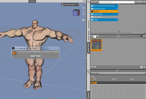

    Of course, I meant the folder into which I put the plugin.
    The key information I needed was
    " I just navigate to it in the Content Library pane, under DAZ Studio Formats > Scripts, and run the file from there."
    I put the plugin in a folder called DeltaX15, because based on an earlier reply, I think that's who created it.
    It shows up but when I click it, or double click on it all I get is an error message.
    Perhaps I've got an old version, version 1.8, is there a newer version? If so, where can I download it?
    Thanks for supplying the clearest answer to my question, unfortunately I'm still not getting it to work. I've uploaded a screen capture.

    Light Panel 20 was the final version, not sure if it's available any more, but if it's by DeltaX15 you can PM him here:
    http://www.daz3d.com/forums/member/messages/pm/295560
    I have LightPanel-20 and it works OK.
    I think it was on 4Shared, but Googling has found nothing, sorry.

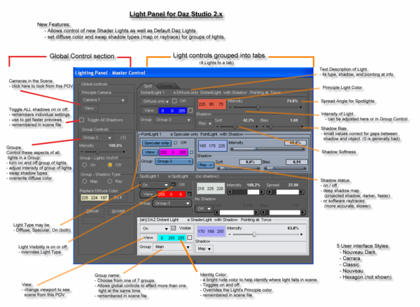

    It's by Neon22. Version 20 was the DS3 version.
  • Neon22Neon22 Posts: 8
    I'm still alive - even if only briefly :)
    The last dsa I can find is attached. (nope)
    -The dsa is in text so you can edit it in the script editor.
    -The dsb files are encrypted and can't be opened. - I used to provide it like that in case I decided to make some products.
    I still have a pile of scripts I meant to convert to DS4. I guess I did manage this one.
    I'm glad it still works.
    The dsa can't be attached directly.
    I tried renaming it as txt and that didn't work either.
    Weird you can't post scripts on the forum...
    So I thought maybe I should put it on my github site. Obvious really... How things have changed since 2010.
    https://github.com/Neon22/DazStudio-Light-Panel
    Thanks drdancm et al for finding me.
    Best wishes everyone...
