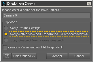

  • CypherFOXCypherFOX Posts: 3,401
    Greetings,
    If you go create a new camera, while looking through the perspective view, it will offer an option to copy the transforms to the new object.
    It doesn't work for custom cameras, like AoA's special cameras, but it does definitely work for perspective view.
    I'm at work, so I can't screenshot it, but I use this functionality *all* the time. :)

    Douh! I somehow read that the other way. Yes, when you create a new camera from the "Create" menu, an option window pops up, asking what settings to apply to the camera.
    The one screen-cap I don't have on speed-dial, and the computer is in the middle of a test render, lol.
    (EDIT)
    Now if you want to move an existing camera to the Prospective view, I don't know. It's just as easy to create a new camera.

  • HeraHera Posts: 1,960
    Thanks a lot Cypherfox & zarcondeegrissom - it worked! :-)
