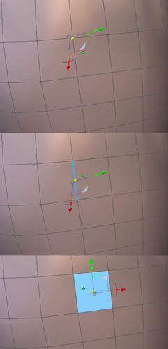

I noticed that sometimes when working on a model and I select a point or edge the manipulator changes shape and appears a little distorted as if its been flattened a bit. But when I select a face it reverts back to its normal shape. So what I've been wondering is, erm, ...what have I done this time?

Alrightie, I tried the little camera icon on the bottom right of Hexagon but the manipulator didn't appear in the cap so I hit PrtScn to get one. The resolution's a bit low but here's the manipulator on the same area of what I was working on. It appears this only occurs while in Manipulator Initialization Mode/Selection Mode. In World and Bbox mode the manipulator is it's normal shape. So it must be a normal function of the Selection Mode that I'm not aware of. :P
Sometimes the manipulator is even more distorted and flattened than whats in this cap while selecting a point or edge.
Yes, what you are seeing is normal - depending on your angle of view and which working plane you are using, the manipulator can appear to be perspective-foreshortened.
If this is a problem, you can rotate the 3D view to get a better angle, switch to camera mode, or define a user working plane.
