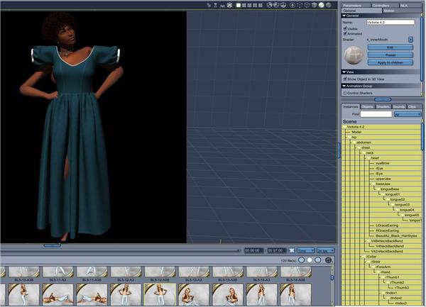

Hello guys!
I've got problem with skirt for Vici 4.2(as you see on the picture below hair works fine). How to fix any part of the clothes for final pose?
By the way... is it noraml that CARRARA PRO 8.5 crashes a few times durring saving a single model/simple scene without background?( Car. Pro 8 was much better than this version I think(:).
1502 x 1085 - 165K

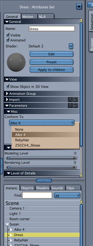

    It looks as if the dress is not conformed to the figure. Select the dress in the Instances Palette and then in the dress's General tab, under Misc, you should see a pull down menu. Select the figure and the dress should conform. You may need to adjust the dress with any provided fix morphs to correct poke-through, and use the handles on the dress to adjust the lower dress to fit the legs.
