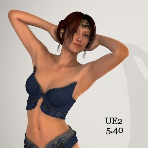

    That said, I still use these lights almost exclusively and rarely bother with UE anymore due to the excessive render load it places on the CPU. The Advanced Spotlight in particular is extremely versatile. Besides flagging, there are several falloff options to choose from (including squared which follows the inverse square rule), they can be turned into point lights by setting the spread to 360° and inner angle to 100%, and they come with a scaleable set of GOBO filters for different lighting effects.
    True, for outdoor scenes you don't have GI, but the trade off is quicker render times. I've created a number of outdoor scenes just using a single Advanced Ambient and Distant light with excellent results. If I need the effect of bounce light, I just add a low intensity wide angle Spotlight with shadows turned off and flagged to create the effect on the surfaces where I need it. Yes it's a "cheat", but that is how the old Light Dome Pro2 worked to simulate GI as well, only with many more light sources. Attached is an example that just used this three light setup.
    1250 x 1400 - 1M

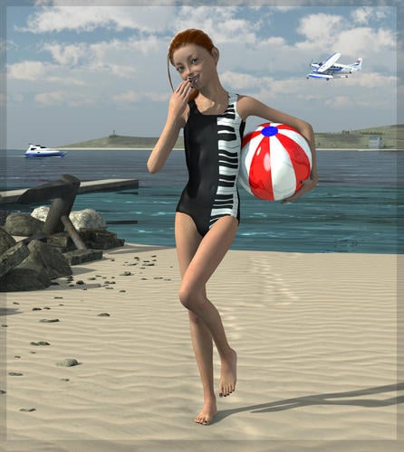

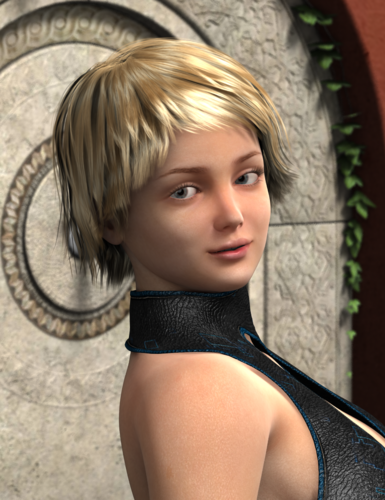

    Love it. That extra spotlight really gives it that sunny-at-the-beach look!
    Here's an outdoor one using only AoA ambient at a lowish intensity and one AoA distant light. That's all. (way in the back is an image.)
    900 x 900 - 180K

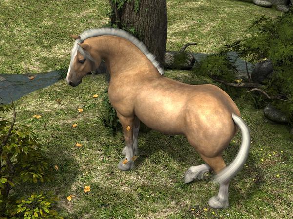

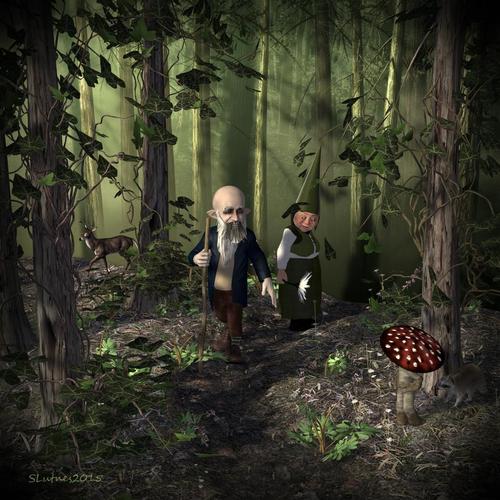

    Picture below is rendered with AoA ambient and distant lights
    1280 x 960 - 756K

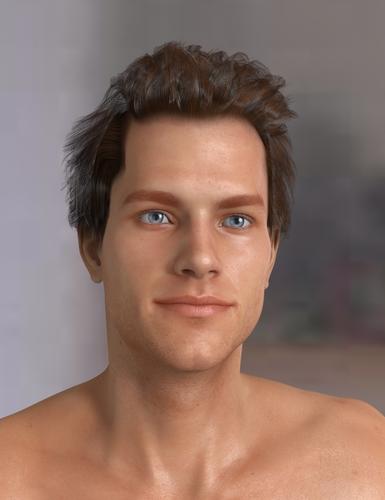

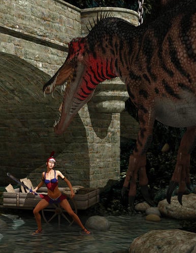

    Thought I'd toss in a few of my own AoA tests. This one is just one AoA ambient light and 1 AoA distant light.
    2000 x 2000 - 1M
