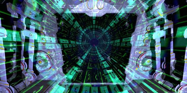

    Yea, it appears I Must close all browser windows before I hit the hay. Seems to be the main culprit but this won't speed things up - just may prevent it from closing itself. This is the only program I've used since getting a pc that frigging closes Itself, repeatedly.
    Here's a render finally (took a day and a half to render this one silly frame). As you see it's a still which means in the process of something unfolding. You can see how the sun is shining in... I move the sun around a lot for it's own lighting effects. I hope to add a layer or two with after effects to enhance the center of the .... (conical) manufactured wormhole, for that warp into space... Yes, via ancient Enochian codes, black ops have been able to engineer implosion chambers, as you see above, which of course can be used for jumping or folding space...etc.

    Thanks for that. Several people, on several occasions, have asked me to post a frame due to the difficulties I've been having with Bryce. I am quite curious as to their comment as I myself didn't see the need to upload anything. It's obviously too detailed = demanding. But if there's one extra tweak in render options to help that would be nice.
    The above morphs in a very cool fashion. Much of what I do is similarly demanding (and dazzling imo) so I've very little to show as far as Duration. But I'm slowly and Non Linearly creating a story line about interdimensional travel etc. I hope to splice in captured footage into this stuff. Will see if fate allows this.
    I like your avatar. Are you perchance into aether physics/electric universe/free energy and all that? The in out of the torus is the central feature there.
    Oh, that faint little red ish spot in the dark center is a space ship coming towards you. The colors of that craft, once it gets closer, reflect off the walls etc which looks cool too.

  • Dave SavageDave Savage Posts: 2,433
    edited February 2015
    It looks very good.
    Having said that it's not overly complex at first glance.
    I guess that what's eating your render time is the transparency. It does that.
    It looks like you may have three nested cones all with a slightly different pattern or number tiles (which I presume are zooming towards the viewer and probably spinning in different directions). If that is the case, you could reduce render time by using only one cone and animating the individual material channels using the Golden Tools. It would mean a quite complex material set up but utilising the Channels A to D in the Mat Lab to put your different trans maps on to would then ultimately mean that Bryce would only have to calculate one Transparent object at render time.
    What other lighting are you using besides the sun? Because lighting set up can also be vastly optimised to reduce render time... For instance, IBL lighting and transparency don't always play well together, but there are ways to set up the IBL that will make it much more efficient.
    Tim is entirely correct, the more information you can give us about how it's set up at the moment will allow us to give you better, more accurate information about how it can be optimised, instead of us having to try and guess like I've just done.

    I've the settings Herr Savage suggested about a month ago. If by transparency you mean fading the material itself out yes, otherwise nothing else like that. This itself can slow it down tho but I need that and there's only one object doing that. Premium is off... Maybe something under Optics could be changed.
    Sun and two radial lights...... Yeah, more light more slowness. But there's slow and then sssssllllloooowwww.
    That frame comes close to the dazzle that appears only a few frames down the line. I was going to post a follow up but we're back rendering. I placed a sphere with the Selene (I think) atmosphere material on it into that center vortex. So as you progress an ethereal blue hue emerges... from hyper space of course.
    So yup one rule is to close All browsers at night (I can surf fine with Bryce rendering). I used to let some sit in the tray so I wouldn't have to surf back. But it appears updating itself may interfere and that is a problem. It wouldn't be so bad if when Bryce closed it automatically saved what was rendered.
