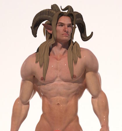

Hey everyone .. I'm trying to use Luxus and Reality 4 with Luxrender but I keep getting these spots appearing on my renders .. they're like some kind of glitch and they seem to appear on every image I do so It's not something specific about Luxus or Reality. Probably some thing I'm not doing right in LuxRender .. or perhaps it's a Mac OS/LuxRender problem .. I haven't tired this on my Windows side yet.
Anyways, if anyone is aware of what might be causing this please chime in and let me know. It's really frustrating that this stuff just don't render without glitches, when there's no reason for it not to.
I've enclosed a (censored) pic of one of my characters that I'm trying to get a decent render of. He looks great .. apart from all this glitch crap! Looks like he got sprayed with white paint.
Look forward to hearing your thoughts .. and fixes if there's any.

    That's not white paint splatters, it's ultra-shiny highlight reflections from your lights. One of the things that Luxus can't yet handle properly is the difference between D|S-3Delight material parameter limits, and LuxRender limits. Shininess is one of the big headaches; a Specular Color setting of e.g. medium grey which gives a mild sheen in D|S is the equivalent of a literally unnatural gloss in LuxRender. The values need to be turned way, way down.
    Go into the Surfaces tab, select all the skin surfaces on your figure, find the Specular Color parameters and darken the colour. (Easiest way to do this; click on the colour swatch to get the Select Color dialog, then look at the Hue/Sat/Val numbers above the OK button. You need to bring the Val number right down, I usually never go above a value of 50 even for a really shiny metal or plastic surface.)

    Yay ... you helped me .. I LOVE you!!
    Cos this problem has been pissing me right off. It's amazing all of these crucial things about DAZ that you absolutely need to know but you won't find mentioned anywhere. I guess it's kinda hard t list it all but damn .. there should be a manual for 'weird things that'll piss you right off' :D
    Thanks for this, I'm gonna go get this out and see what the outcome is. I had imagined it might be something like this. Oddly enough the characters legs are nice and shiny but they made me crop the damn picture ... fail to see what the hell is wrong with having a big black circle over his naughty bits ... what age are we here .. 12? Anyways .. again my thanks and it'll be great to make some progress with LuxRender.
    It's too bad the Lux takes so damn long to render a decent image .. it'd be nice to use it for animation but that'd take weeks to render even 15 seconds of animation.
    My demon boys thank you very much :D
