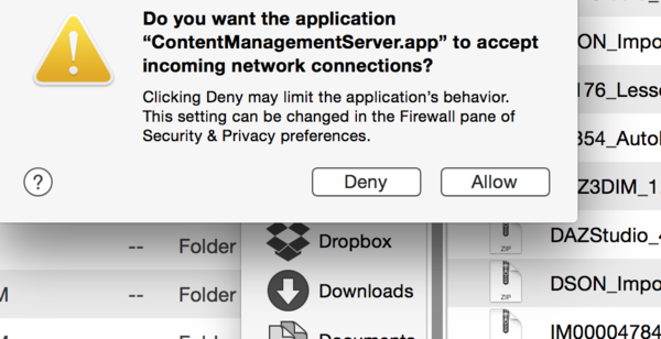

    The middle image (the one attached below) is the pop up I got every 5 seconds. I managed to click on Deny and Accept while it flashed for one second, but I still got pop-ups every five seconds and was unable to use my computer at all. Had to uninstall.

  • fixmypcmikefixmypcmike Posts: 19,719
    That's not a virus. The Content Management Service needs to communicate with DAZ Studio and DAZ Install Manager -- since you are blocking it, it keeps trying and failing to connect. It is only a local connection, and doesn't access the internet.

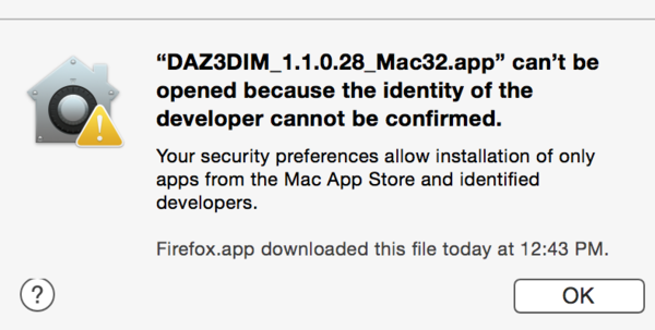

    Hi,
    First, download the one for your system. If you are on a newer Mac using Mavericks or Yosemite, you're likely on 64 bit, so use that one.
    You have your Mac set up to only open verified programs, which is good, so if you know you want the program, instead of double clicking, right click the program and select open and then open again in the next dialog box.
    Do accept network connections.
    See if doing it that way helps.

  • TotteTotte Posts: 15,113
    You need to go into the firewall settings and enable both the postgres CMS for accepting local connections and DAZ Studio and DIM to talk to the CMS, it all depends on how you setup your firewall to begin with.
    The second "can't run problem", rightclick - open that will tell GateKeeper that you trust the program to run.
    As I said before, right click the application in the finder and select "Open", this will tell the OS X Gatekeeper that you accept to run this application and gatekeeper stores that information so next time you run it, it won't ask.
    The default security settings are painfully paranoid and really says that you only will run things bought through appstore.
