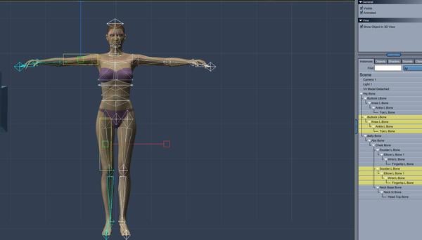

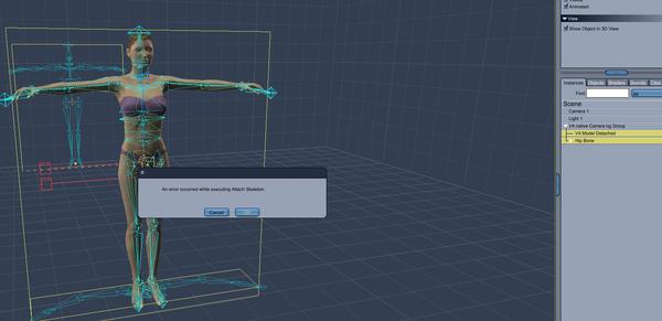

    I decided to try to do a native Carrara rig for the V4.2 mesh, but it didn't work out. I had what to me is a strange error. I tried to do a native rigging of V4 in Carrara just to see it. I am getting an error when I try to attach the new skeleton to the disembodied mesh. Seems strange. Here are the steps I followed if anyone can spot my mistake.
    - loaded V4.2 from the My Daz3D Library Runtime.
    - loaded some morphs from the Daz pose folder to V4 (base, morphs++, elite, and Aiko4)
    - selected V4 and then used the EDIT: SMOOTH OBJECTS menu to convert the mesh away from smoothing
    - selected the model and the skeleton hip, then used the animation tab to "detach skeleton."
    - I then went in the vertex modeler, selected the whole mesh, and created a new morph zone called All1, and made and validated a sample morph.
    - I then saved the V4 mesh (but not the old skeleton) to my objects browser
    - I closed Carrara and started a new scene
    - I loaded the detached mesh from the objects browser
    - I used the bone tools to create a new native Carrara skeleton for V4.2
    - I selected the hip bone and the mesh, then tried to "attach skeleton"
    - I got an error (which I did not expect).
    Thoughts?
    1442 x 700 - 120K
    1436 x 819 - 109K

    I exported and imported the V4 mesh to get a clean obj. I was able to rig it using Carrara's native bone tools, but it lost all the Daz morphs. My initial guess is that a native Carrara rig of V4 would lose more in terms of the preset morphs than it would be worth.
    834 x 799 - 75K
  • RoygeeRoygee Posts: 2,247
    I also got this error when attempting to attach a Carrara skeleton to a V4 model which had been stripped of the skeleton. When doing this with a V4 which had the skeleton stripped out, but without saving to the browser, the option to attach skeleton is greyed out.
    I guess that when you detach the skeleton, you are breaking the .cr2, which is why you loose all morphs ERC, etc. I'm pretty sure that back in the day, around C6 or 7, we used to do this experimentally and it worked - but I could be mistaken. We were then more concerned with trying to use the skeleton on a home-made figure than re-rigging Daz figures. This did work, but far more trouble than it was worth.
    BTW, when you detach a skeleton, you only select the model, not the model and skeleton.
    About weightmapping - they probably didn't refer to it as "weightmapping" in the older Poser, but that is what you were actually doing when making a .cr2 figure, as the term is commonly understood in the CG world.
    In fact, skinning - which is the action of attaching a skeleton (or armature, as it is more commonly known) is not the only use of weightmapping. When you paint a distribution map on a terrain, for instance, you are actually weightmapping. In Blender, exactly the same tool and process is used for bone influences as for distributing instances on terrain and many other functions where you need varying influences.

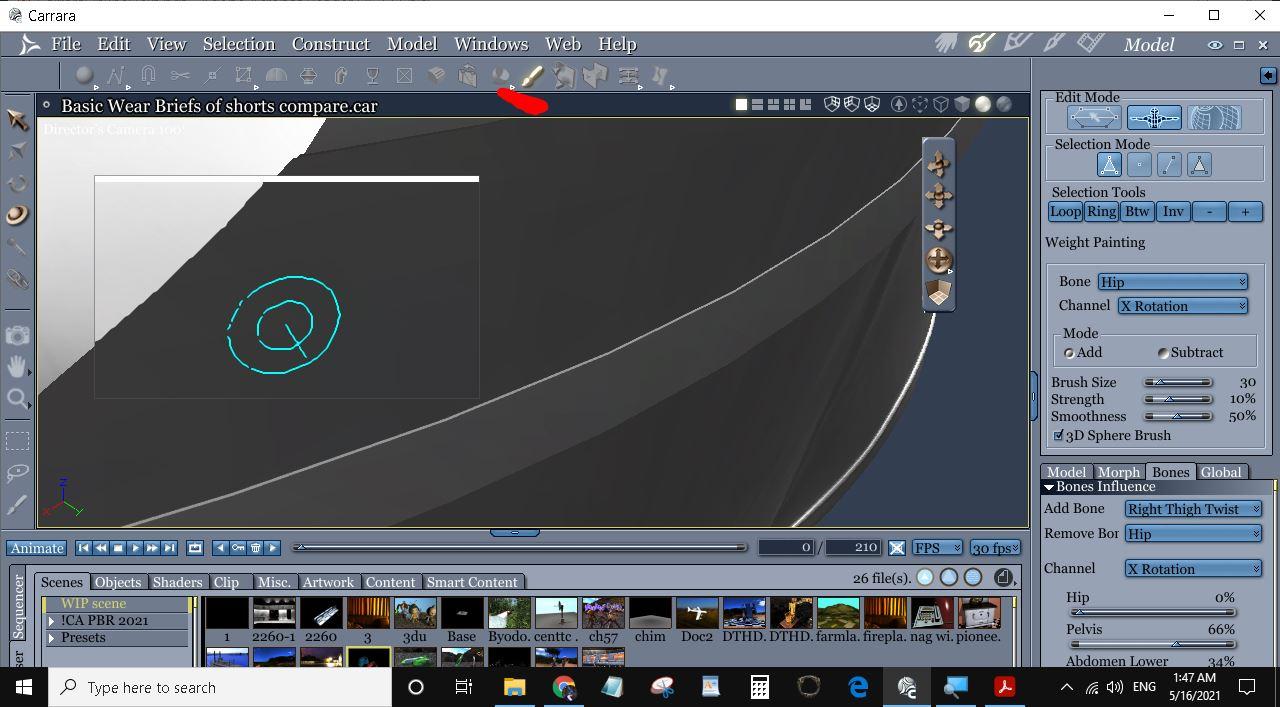

    how do you activate the carrara weight map tool?
    thanks.
    found it in the vertex model, animate, select a faces
    1280 x 707 - 148K
