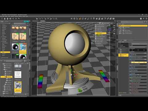

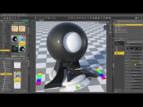

  • The second tutorial video is up now -- this time the subject is using iMetal for non-metallic materials.

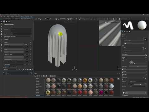

    Here is the last video tutorial:
    This one covers how to use the Substance Designer and Substance Painter new document templates and MDL shaders, which you can find here: https://www.deviantart.com/halflifecomics/art/iReal-Templates-for-Substance-897050744
