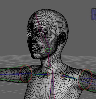

    The first pic is a skinsuit in DS3, what your seeing is pretty much what you'd get in DS1 & 2 as well as Poser, except I have it on wireframe view as well as having the joint editor active to show the bones. The CR2 is almost the same as the figures, I've removed some of the bones (eyes, fingers and toes) as well as removed the geometry reference from the head, hands & feet bones.

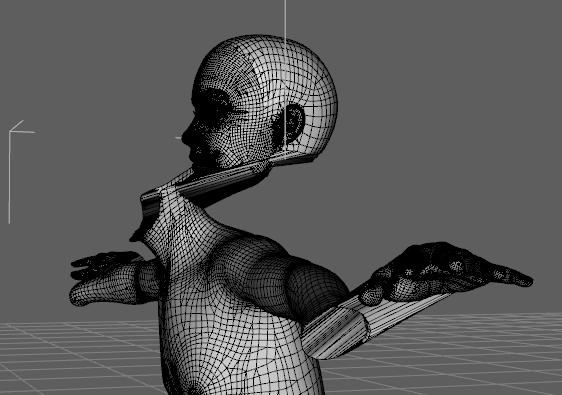

    The second picture is the exact same CR2 in DS4, as you can see the geometry references in the CR2 are being ignored by DS4 and it's loaded the entire mesh, the head, eyes, hands, fingers, feet and toe groups are now completely static lumps that get dragged around with the figure, none of the joints have any effect on them.

  • BerBuzBerBuz Posts: 64
    Bejaymac, this is not exactly my case although there might be a relation in the fact that it clearly shows that DS4 have a different behavior.
    In the second image, when you move the head, does the eyes moves along with the head or floats in the air? In my case they will float!

  • BejaymacBejaymac Posts: 2,000
    The head & eyes don't move, in my case they weren't meant to be loaded so the joints have no control over those groups, if I bend the skinsuit at the waist then the head, eyes, hands and fingers stay where they were and the mesh gets distorted at the group seams.
    Despite the fact that the head mesh is visible, the behavior of your model seems correct to me: descendants are moving with their parent.
