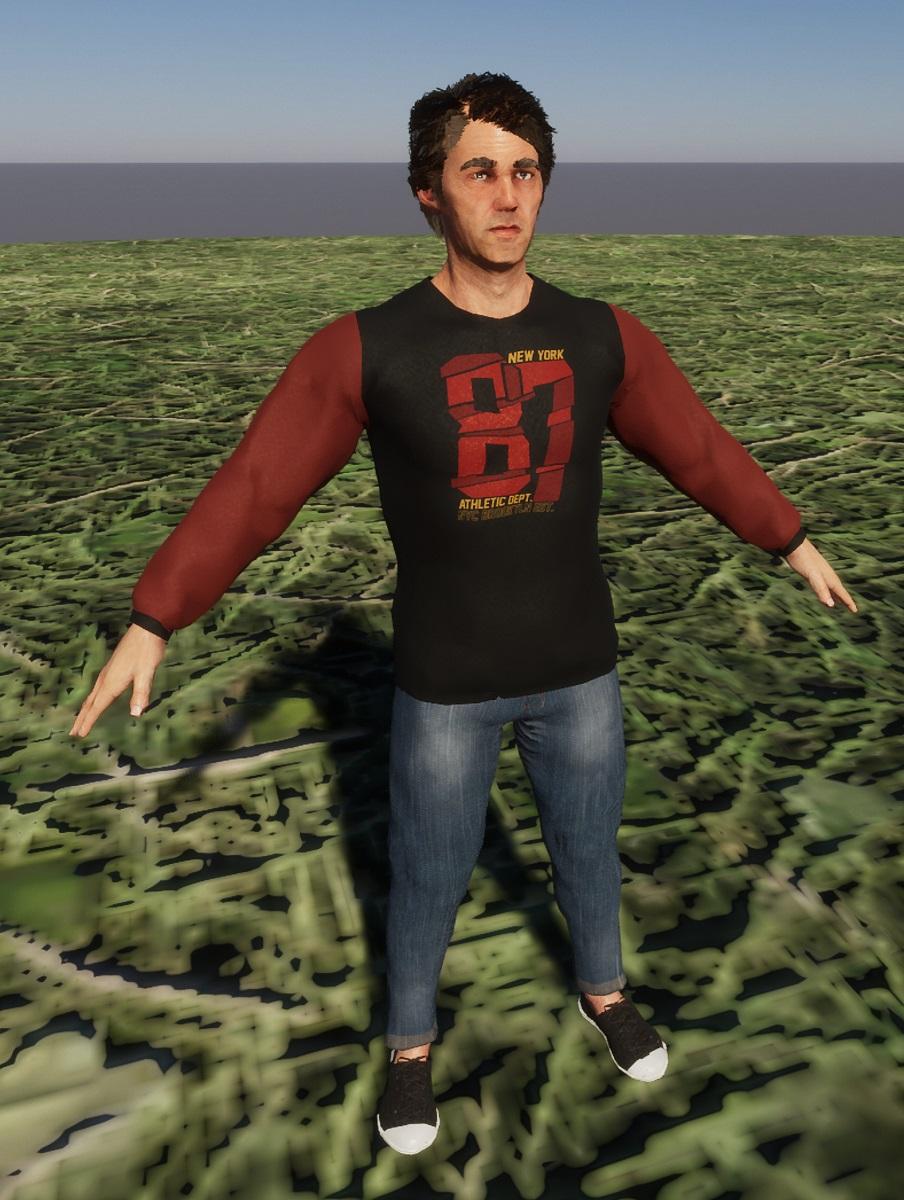

  • ArtiniArtini Posts: 10,921
    edited November 2021
    Ok, I have thought, that the main goal was to get a low poly figure.
    Below is a render from Unity of decimated Christian 8 with clothes and the hair.
    Total number of polygons is about 50000 (less than 10% of the original number).
    Still looks not so bad for a background character.
    https://www.daz3d.com/christian-8
    https://www.daz3d.com/carlos-hair-for-genesis-8-and-genesis-3-males
    https://www.daz3d.com/dforce-back-to-class-for-genesis-8-males
    904 x 1200 - 292K
    Post edited by Artini on
