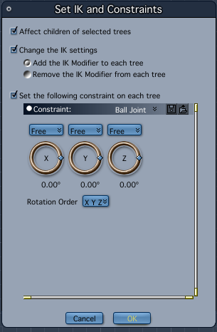

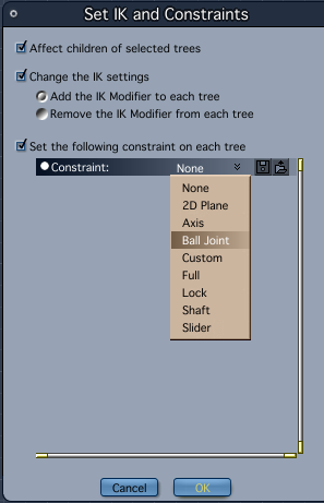

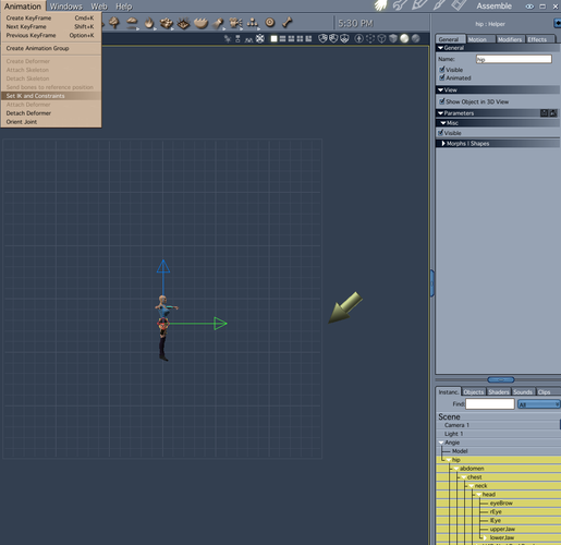

    To change the whole figure at once, select the Hip (the first bone in the hierarchy) and then choose the Animation menu at the top of the screen. Next click on IK and Constraints. A new window will open. If you set up the options the way I have them, all the joints should be changed at once. I would try using the ball joint setting first. the joint rotation will be free, but the bone is still attached to the other bones. This should avoid the Stretch Armstrong look.
