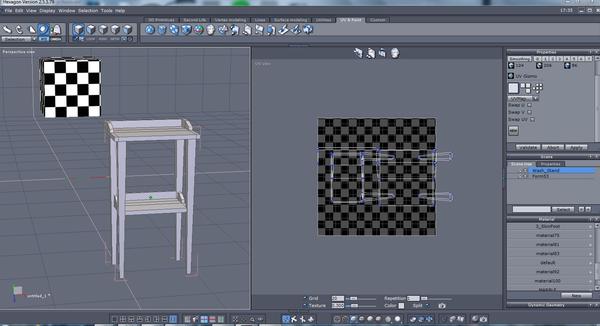

  • DarthDDarthD Posts: 259
    This one has no texture applied but I can't see the grid. If I apply a texture nothing happens. Also, I have a lot of materials that are not used. This is the only object in the scene. How can I remove unused materials?

  • RoygeeRoygee Posts: 2,247
    First off - the UV mapping looks pretty bad, with lots of overlapping and bits and pieces all over the place. Secondly, much of it is off the grid - all islands must be on the grid for the texture to show on the model.
    Thirdly, if you look at the settings at the foot of the UV window, there is a setting for the visibility of the texture - you have it set at 0.300. It needs to be set at 1 to get full, opaque visibility.
    To remove materials, click on the little arrow next to each in turn and select "Remove material" - unfortunately, this cannot be done in bulk.
    Once you have got all that sorted, load the texture through the materials tab - you will probably have to flip it vertically to get it to display correctly.

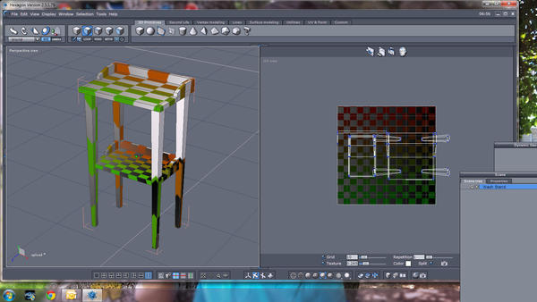

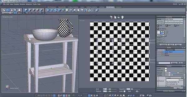

    Here is the bowl.
    1591 x 835 - 296K

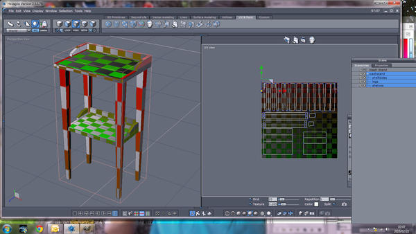

    I think the problem is that you are using projection mapping on objects which simply don't lend themselves to that method. Take for instance the jug - by the checkerboard pattern, i take it that is projected, probably from the spherical projection. The shape is too complex for that approach. I don't see the UV map for that, so can't really judge.
    Then there is the bowl - this is double-sided, but it appears that this was also done using a projection method, so the inside and outside are superimposed. Not too bad a method if you want the inside and outside textures to be the same.
    What you need to bear in mind is that there are two totally distinct methods of UV mapping - simple projection, using the first four icons in the row under UV mapping and actually "deconstructing" the model by cutting it with seams, using the head next to those four. Projection mapping is only suitable for very simple shapes, such as the bowl. For everything else in the scene, you need to unwrap it to get an accurate UV map.
    I took the liberty of modelling the washstand and UV mapping it - see the attached pic. This is what the UV mapping should look like - not saying it is optimized for whatever texture you want to put on it, but it should look something like this.
    One of Hex's big drawbacks as far as UV mapping is concerned is that it only allows for projection in one of the three axes on a single mesh. As example, for the washstand, ideally I would do an unwrap of the legs in either he X or Z axis, the sides of the shelves in the X axis and the actual shelves in the Y axis. Being restricted to one axis meant i had to choose one, then spend a lot of time untangling the spaghetti, and reassembling it. The actual modelling took about 5 minutes, with another hour spent reassembling the UV map.
    What could be done is to cut up the model into its component parts and unwrap each in the optimum axis. Another method would be to delete three of the legs and one of the shelves, UV map those and replicate. Saves a lot of work, but means that your texture would be repetitive and boring. Doing it the way I have done allows you to make subtle changes to the different parts of the texture map and introduce some variance.
    In any case, if you followed the advice in my first post, you should at least have a texture showing on the grid, even if it is not correctly shown on the model.

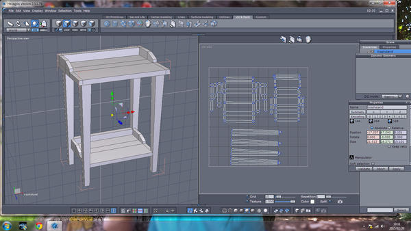

    I would have liked to see the full file, including the bowl and pitcher to take a look.
    First observation was that, if the original model has a texture on it, it must have been a procedural texture, which does not need UV mapping, because there is no way the model you sent me, with the UV mapping as shown, could have held a mapped texture decently.
    If you look under the options for texturing in the materials panel, you will see an option to load a texture checker. This is very handy to check that the uV mapping is correct. Good UV mapping will show a clean checkerboard, evenly spaced. The first pic below shows what the original I received from you looks like. The checkerboard is distorted, especially on the legs - the white part shows where UV mapping for the top of two legs are outside the grid, so will not get any texture allocated.
    In the second pic, I have disassembled the model into its component parts so that I could do planar projections from different axes. You can see the checkerboard is evenly distributed, without distortions and all of the UV map is within the grid, so all parts get texture. It imports into DS as a single entity, so should work for you.
    This map is not ideal, but will take a texture. Ideally, I should use the unwrapping option instead of planar projection, but, with Hex being limited to a single projection axis, it means going through a lot of fiddly work to get everything sorted out and has to be "eyeball" scaled, as another of Hex's failings for UV mapping is that it does not do proportional mapping.
    I have checked the UV mapping by 3D painting a wood texture on it and it works just fine:)
    I will post the corrected file, with some suggestions on how to get a texture onto it, to Drapbox and PM you the link.

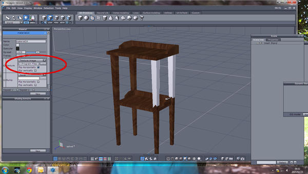

    OK - I see what you are getting at :)
    Yes, when I loaded it directly from your post, without any changes, it gave me the distorted checkerboard - after I had made a new material and selected the checkerboard.
    The first pic shows it "as is", with a wood texture applied through the materials panel. If you look closely, you'll see that the texture is distorted - the white are is where the tops of the legs are outside the UV grid.
    The second pic shows the same texture on the re-mapped version.
    What you need to do to get a texture loaded is to remove the current material, select the def-surf-mat shading domain, make a new material and in the drop-down menu select texture image and load from there. You will then be able to manipulate the UV's to get the texture aligned correctly.
    1600 x 900 - 278K
    1600 x 900 - 281K

    BTW, a little more messing about with the wash stand showed that using the box projection method gives a pretty reasonable result, if you are not up to the full unwrap method. Not ideal, but good enough as a starting point to manipulate the islands for better results.
