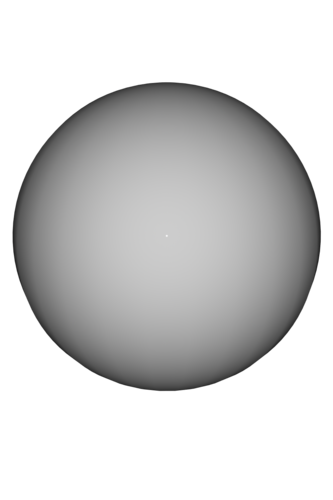

    I'm also using this version...same network as yours Richard
    Still no displacement.
    1000 x 1500 - 535K
    Thought I'd try a different texture with the same network. This time I used the checker default settings on the brick and the displacement works. So there is a problem when combining displacement with the granite brick despite the granite working in the diffuse.
    1000 x 1500 - 658K
