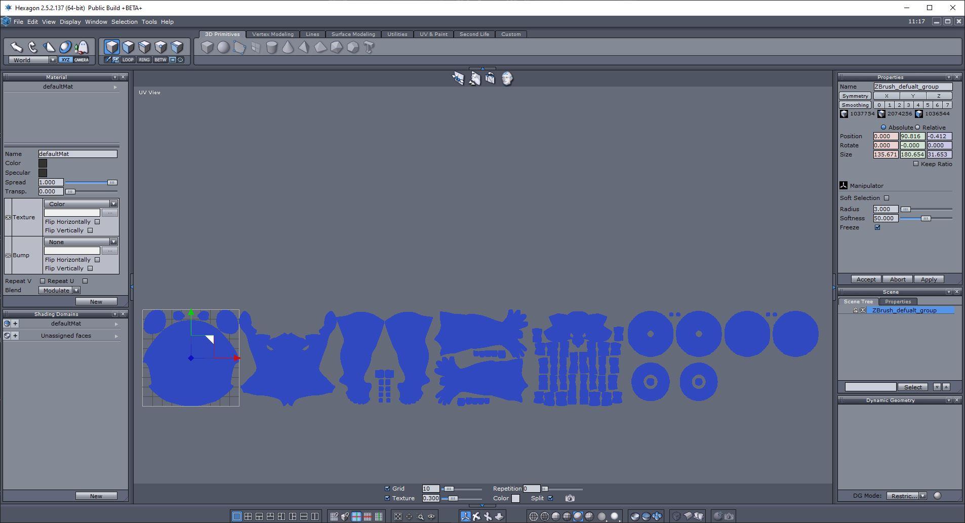

  • WendyLuvsCatzWendyLuvsCatz Posts: 41,673
    edited October 2021
    yes Hexagon can and you can send to DAZ studio too via the bridge after assigning surfaces

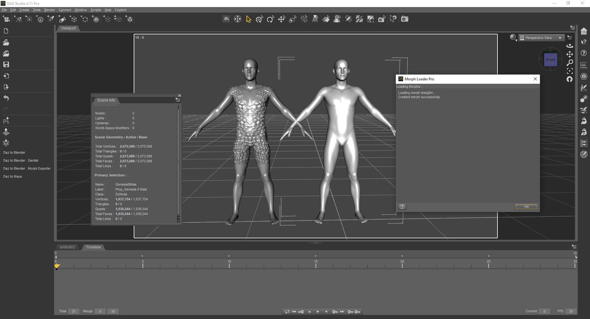

    edited October 2021
    mine was subdiv3 and it worked
    • load your figure set subdiv to match the imported obj
    • edit Rigging, convert to prop
    • edit object morphloader pro, import morph obj
    • add your texture maps and render
    • or whatever else you want to do (transfer utility to rig it maybe?)

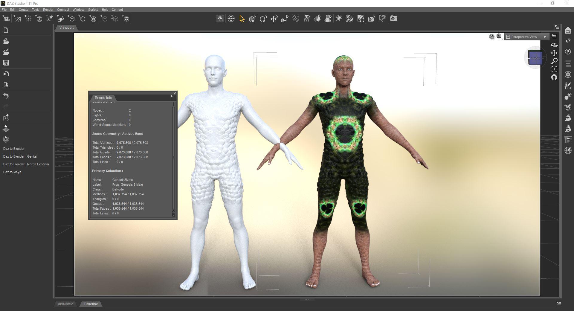

    HDskinsuit
    rigged converted to prop subdvided 3 G8M with transfer utility, loaded the subdiv 3 HD morph with morphloader pro
    hide lips and mouth eye bits as they go nutzoid as welded
    hide all his skin except lips eye and mouth parts
    1920 x 1040 - 169K
