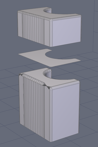

    you've got to chamfer smart. you also have to build smart from the start. that means avoid boolean to cut shapes into objects. sometimes you also have to make a shape by closing a hole, taking that closed hole face and cutting it out, giving it thickness, then chamfering those edges.
    Image from bottom to top:
    original shape; atempted to shamfer outer edges, bad geometry
    second shape; flat n-gon face cut out instead
    third shape; flat face given thickness, edges chamfer as intended
    it's kind of a quirk in how hexagon works.
