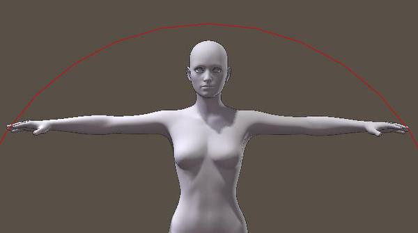

The 1st image shows Genesis 2 female base loaded in Poser Pro 2014, nothing done (except removing materials), the figure shows just fine.....
Now in the 2nd image the option 'Use Limits' is set in Poser; notice the strange effects on the breast... and the bar behind her head is actually her tongue!.
Anyone any idea why this happens (and can it be fixed)? Using the üse limits option can be very helpful in setting up an initial pose...... before fine tuning it beyond the limits if so desired.....

  • Richard HaseltineRichard Haseltine Posts: 111,965
    Try zeroing the figure - it looks as if something is driving one of the pectoral bones and the tongue root in an odd way.
    OK, zeroing doesn't work. I see the twist on the breast controls, and another on the hips, but I don't get the tongue effect. I will report this as a bug.

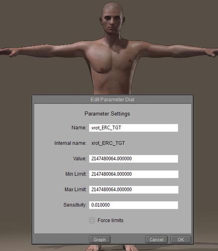

    Whilst I don't see the problem with the tongue base, it is certainly a similar issue with the the collar actors as with Genesis 1. It happens in both the Male and Female versions The Upper and Lower limits for the x,y and z rot and trans _ERC_TGT are 2147480064 for both collars. Since this is not happening in Studio, it must be an issue with the DSON Importer.
    I'm using Poser Pro Game Dev, build 10.0.5.28445, ..
    536 x 617 - 27K

    I discovered that I hadn't updated to the latest DSON importer, which I did, and it still occurs. It also still occurs with Genesis 1, which I reported as a bug almost two years ago.
    Putting a minus sign on the lower limit value for each of the _ERC_TGT values before clicking on Use Limits fixes it, although a limit of +/- 2 billion isn't much of a limit..... :-)
