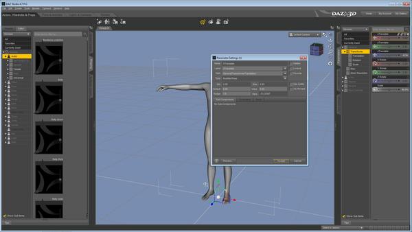

  • AndySAndyS Posts: 1,449
    edited February 2015
    Hello Richard,
    what is really crazy I show in the attached screenshot.
    I can't drive the x-Translation and it shows the locked symbol.
    But opening the parameter settings dialogue, there isn't any "locked" or "use limits" selected. ???
    So perhaps it is a functional defect of the program itself ?
    Andy
    Hi folks,
    so even a deinstall and reinstall didn't help.
    Sorry:
    It is not the locked property - it is the controller override. You see that symbol in the screenshot.
    So x-Translation is overwritten by another control - but can't find what.
    Andy
    Post edited by AndyS on
  • Richard HaseltineRichard Haseltine Posts: 111,647
    The symbol shows the current state - in your screenshot the X Translate has an open padlock, meaning it is not locked. Nor is it limited. The only thing I can think of is that a zeroed parameter has been set as a controller, with the link set to multiply. Click on the Controllers tab at the bottom of the Parameter Settings dialogue - is anything listed there?
