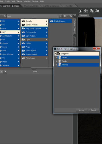

    But some stuff has both Genesis 1 and 2 (just to name something) so I need to split things like that by categorizing, but when I click right mousebutton and choose "create a category" it only shows my default, Reality and a random theme category.
    I added a screenshot.
    You'll see a row with M5, V5, G2M etc. those are my own paths I installed my content and that I added with the content directory manager.
    those don't show up when I want to categorize my stuff :(

  • barbultbarbult Posts: 27,508
    edited February 2015
    I apologize if I have misunderstood your problem, but are you perhaps confusing content directories with categories? Content directories are physical folders on your hard drive. Categories are are like tags assigned to the assets in the content directories.
    Another possibility is that your categories were created under the Default category and you need to expand the Default category to see the sub categories. I always create my custom categories that way (i.e as sub categories under Default).

    Yes Barbult, I know the difference :) I just wanted to explain myself a bit better ^^
    I will try to repair the database again and hope it works then.
