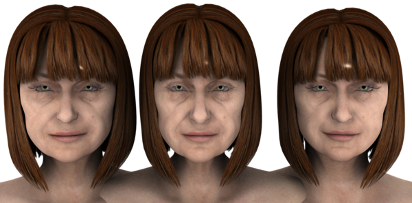

    Hi,
    In my experience GenX2 transfers to Genesis 2 every bit aswell as Genesis 1. In theory Genesis 2 is capable of a closer match than Genesis 1, since there are a few more polygons in the head, but in reality both of such close matches I struggle to see a difference. I have attached an example, I used quite a strong and distinctive V4 morph, http://www.daz3d.com/francesca-for-v4 so that any differences would be more likely to show up. The heads show V4, Genesis 1 and Genesis 2, I will let you decide which is which :-)
    1420 x 700 - 1M
