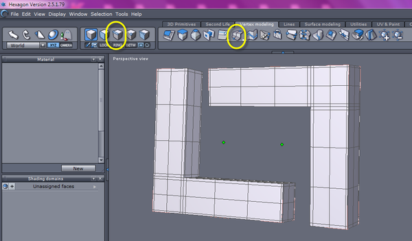

I have Hexagon 2.5 and when i model a shape sometimes there is something wrong with the shape when i send it to DAZ. this is very frustrating to me and im just wondering if it has something to do with the graphics or something else. if anyone could explain that would be very helpful. see attachment. thanks!!

Yes there's something wrong with the model. Delete all of the stuff that the manipulator is sitting on and remake that into one face normal.
Then to hold the edges, some additional tessellation lines need to be added. When you apply smoothing in Hexagon, you'll see what a difference it makes.
N-gons bad!
Patience55: Thank you for the tip! it really worked and i am now pleased! Im still getting used to the program. Thanks again for the info!
