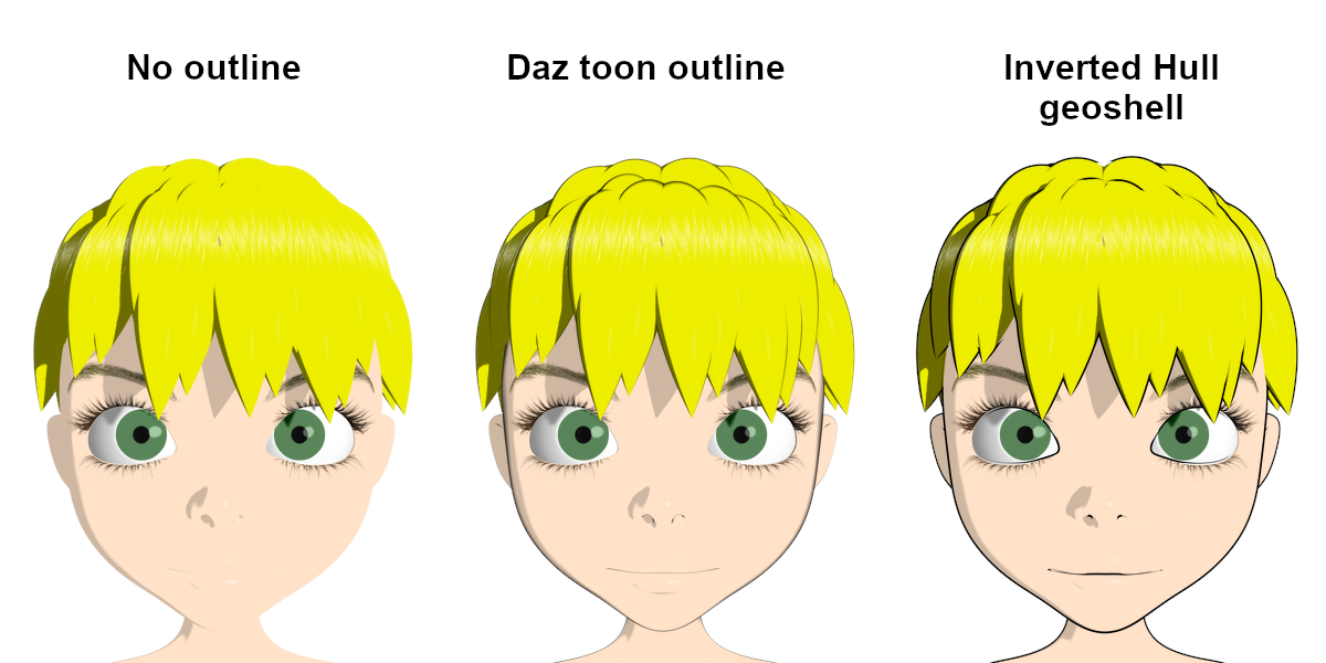

A) Inverted Hull in 3Delight
The idea is to add a geoshell to a model and make it so that the faces of the geoshell facing toward the camera are invisible, while the faces facing away are visible. Because most of this backward-facing geoshell is hidden by the model, the end result is a colored outline that fits the model.

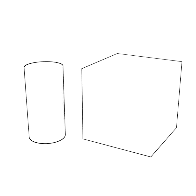

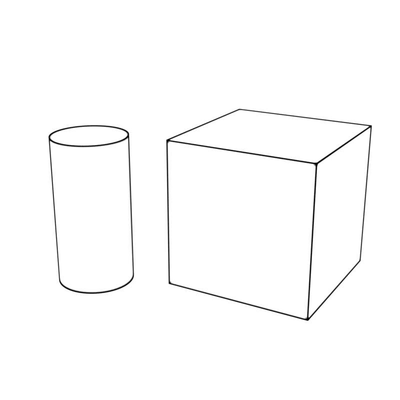

The following picture is a comparison of various versions of a 3Delight render: no outline, Daz toon outline (RSL Toon Outline brick) and my implementation of Inverted Hull (geoshell with custom frontface culling shader).
Comparison between no outline, Daz toon outline, and Inverted Hull geoshell

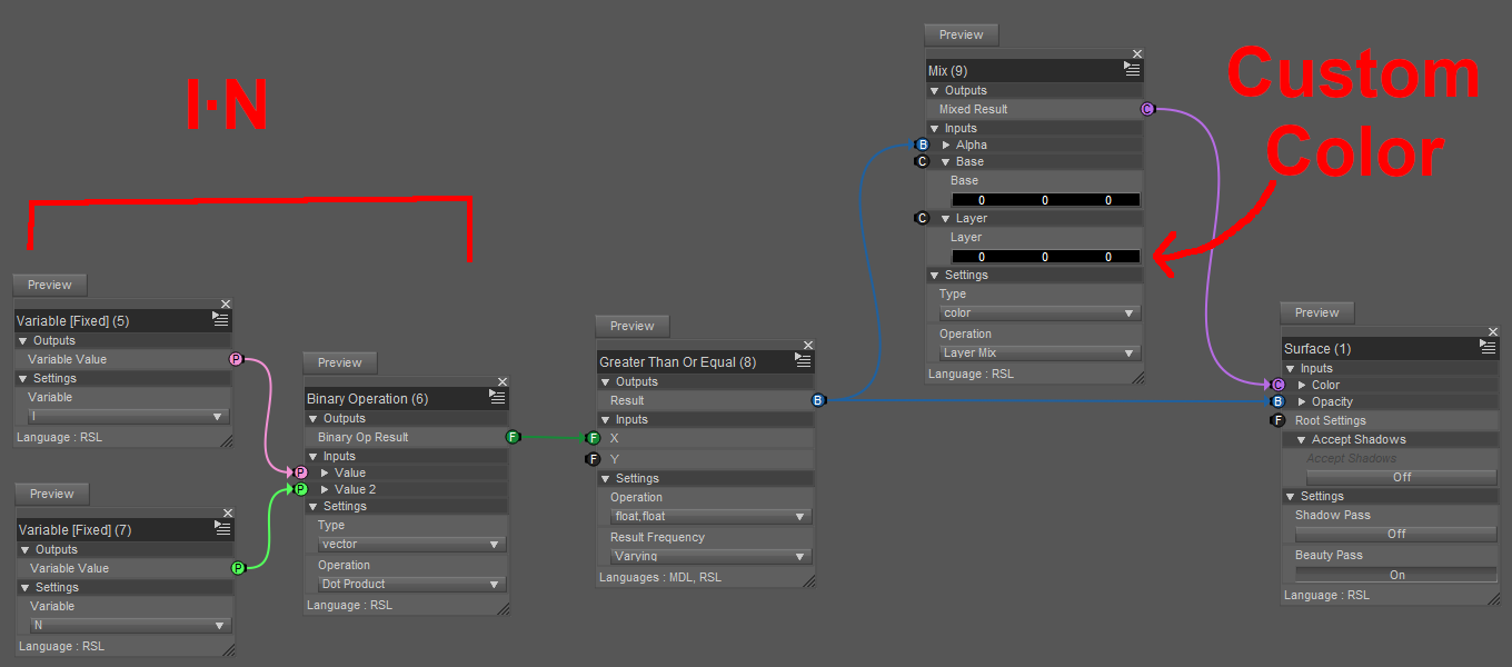

Ideally, I would just flip the normals on the geoshell and rely on automatic backface culling, like it can be done in other tools like Blender.
However, I couldn't find a simple way to do that in DS, so I decided to create a custom shader in which the dot product between the "I" vector variable and the normal is used to drive the opacity of the output.
The following picture shows the 3Delight shader used to generate the Inverted Hull effect above.
Annotated Inverted Hull 3Delight shader

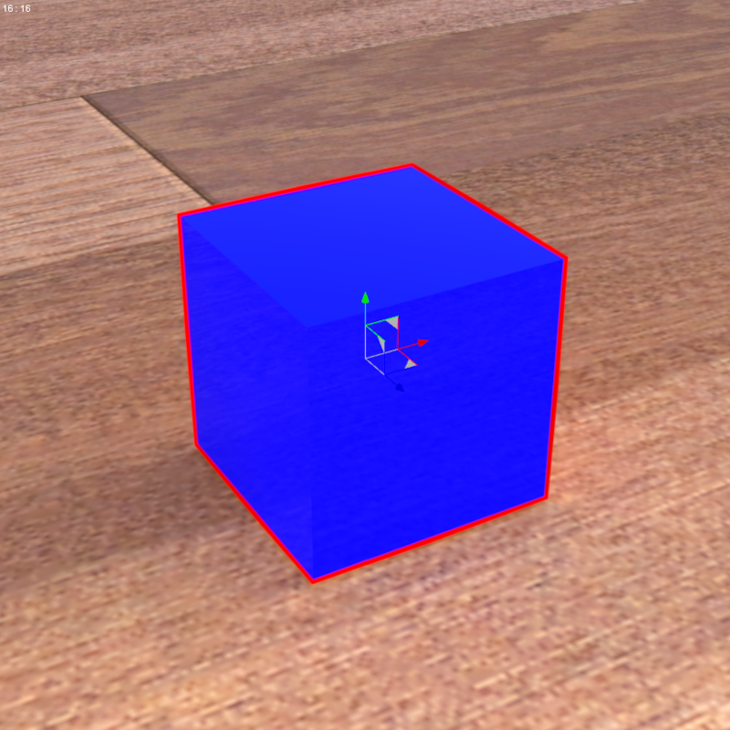

For the sake of clarity, I will be working with the following setup: textured plane + blue cube + red geoshell.
Blue cube on a textured plane in Iray viewport, and same with red Inverted Hull in 3Delight render

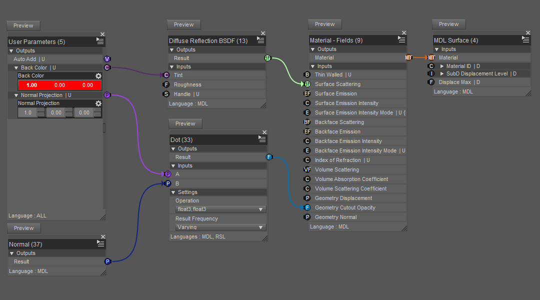

Thanks to a post on two-sided materials I was able to figure out a brick network that theoretically should have allowed me to do what I wanted:
1. Setup the foundation: User Parameters (Utility/User Parameters) → [Tint] Diffuse Reflection BSDF (MDL/Default Modules/df/Diffuse Reflection BSDF) → [Surface Scattering] Materials Fields (MDL/Materials/Material - Fields) → [Material] MDL Surface.
2. Compute the difference (Mathematical/Operators/Subtract) between the manually entered camera position input and the output of the Position brick (MDL/Default Modules/state/Position).
3. Normalize (Mathematical/Standard Functions/Normalize) and compute the dot product (Mathematical/Standard Functions/Dot) with the output of the Normal brick (MDL/Default Modules/state/Normal).
4. Compare to zero (Mathematical/Operators/Greater Than Or Equal) and connect to the [Geometry Cutout Opacity] pin of the Material Fields brick.

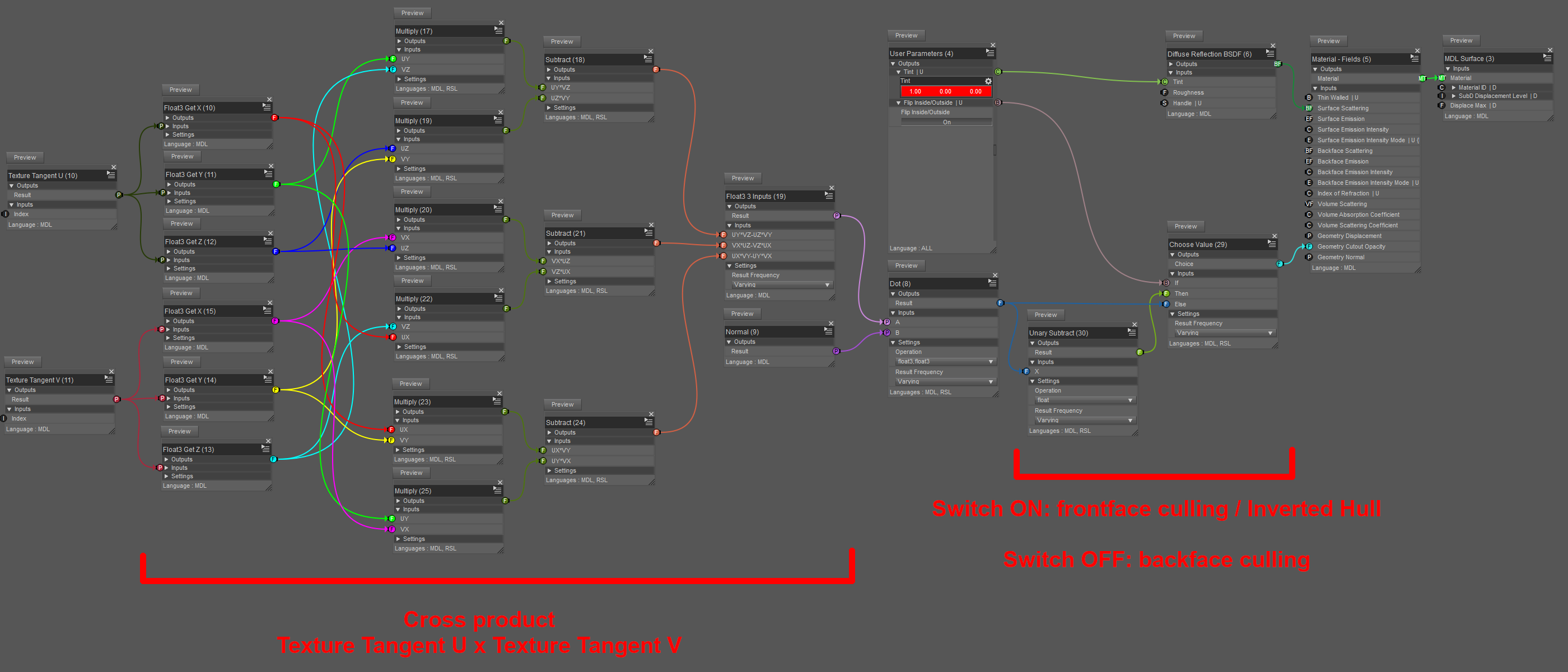

Now, is there a way to get this information? A look at the list of bricks in (MDL/Default Modules/state) reveals bricks named Texture Tangent U and Texture Tangent V. If those are vectors in 3D space, then there is a way:
1. Compute the cross product W=UxV. W should be a vector normal to the surface but pointing only on the outside.
2. Compute the dot product W·N. The signum of this dot product should tell whether the normal that we are looking at is facing inside (<0) or outside (>0).
3. Set the geometry cutout opacity appropriately.

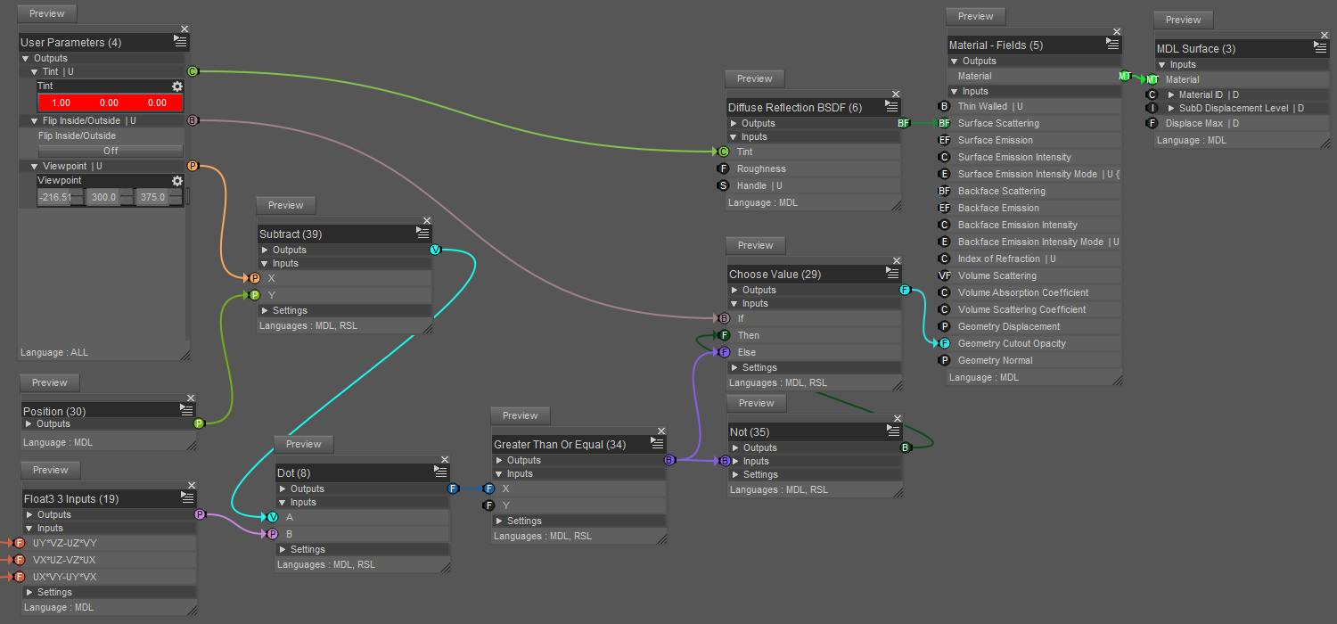

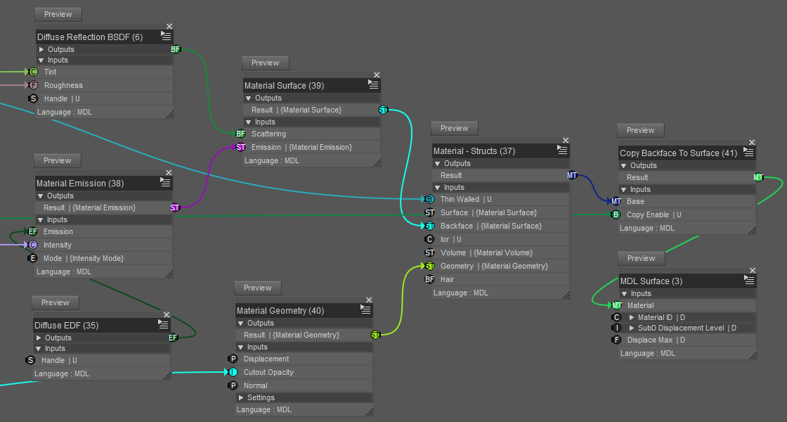

For testing purposes, I added a switch to toggle between frontface and backface culling. The shader looks more complicated than it actually is because I couldn't find a brick to compute a cross product, so I had to do it explicitly. Anyway, here it is:
Face culling Iray shader

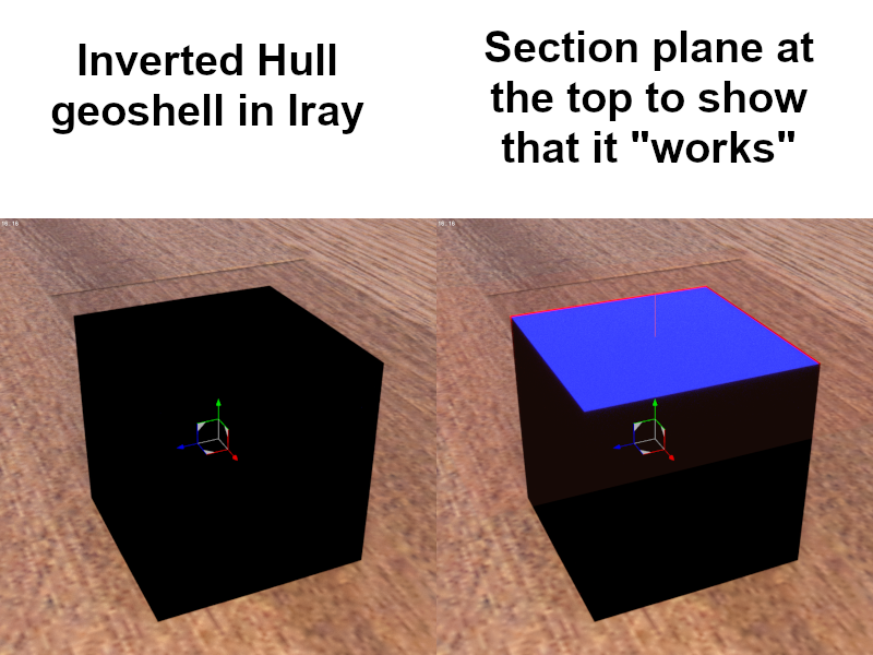

So I did all that, tested it, and... It works!
Sort of.

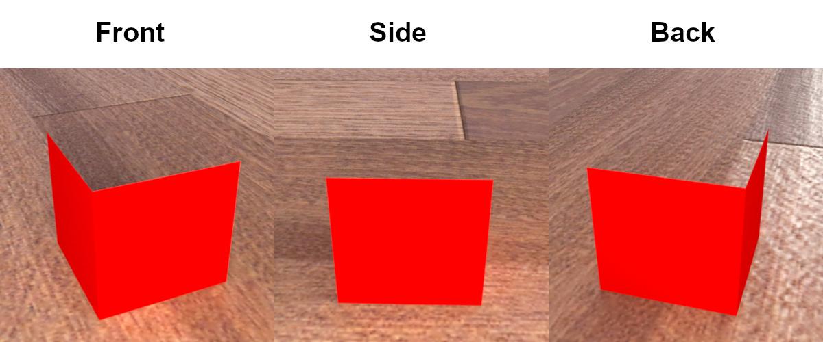

The good news is that this shader does backface culling with the switch ON. Here is a visualization after removing the top part of the box with an Iray section plane, so we can see that the geoshell faces are invisible from the inside (again, the cube is hidden, only the geoshell is shown):
Orbiting around a cube geoshell with backface culling in Iray
By the way, the shader can be applied to anything, it doesn't have to be a geoshell.

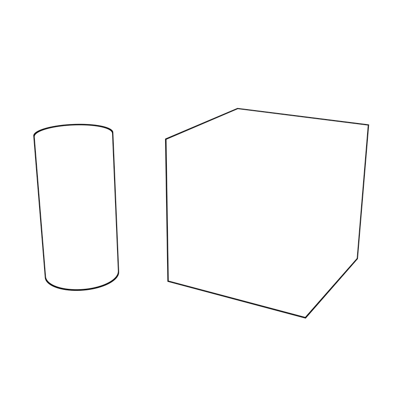

Now for the bad news. It seems that setting the cutout opacity dynamically in this way does not make the faces transparent to light rays.
In other words, even though we can see through them, as far as lighting is concerned, they are opaque. The following pictures show the results a couple of experiments, this time with the cube visible and the switch OFF.
Iray Inverted Hull experiment results 1/2
Iray Inverted Hull experiment results 2/2

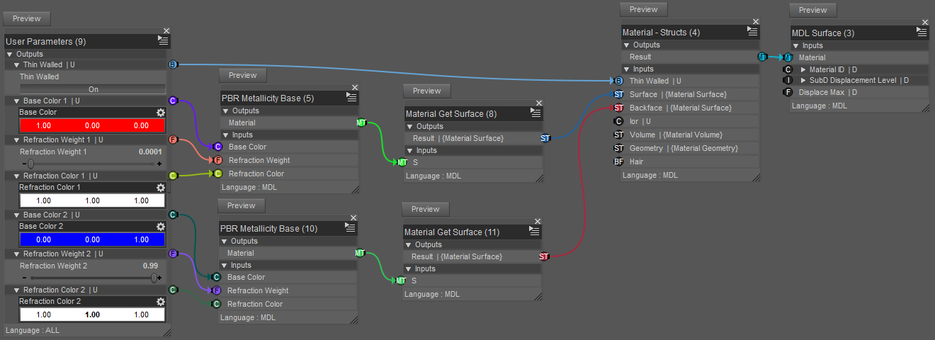

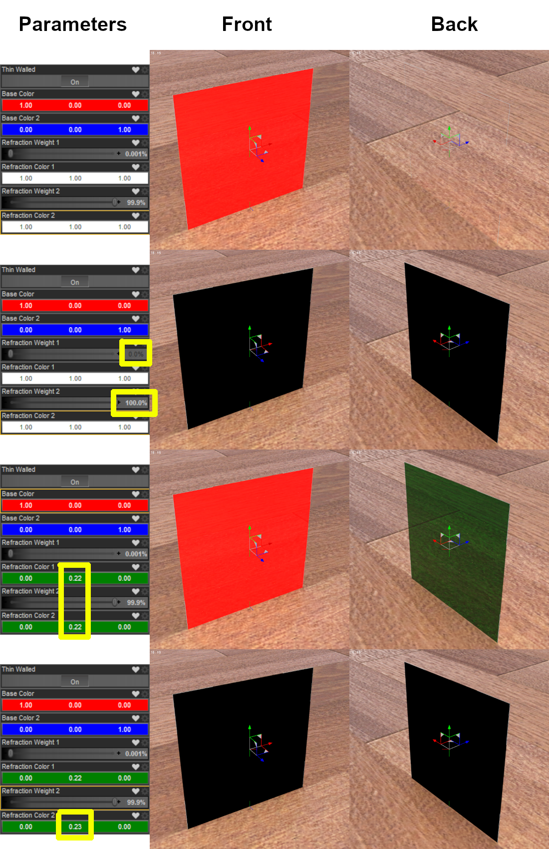

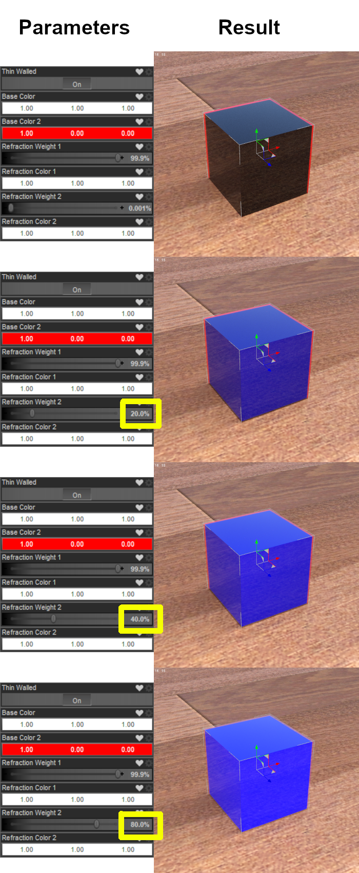

    Consider for example this simple two-sided PBR shader (I only connected the pins that I needed for testing and transparency):
    Two-sided PBR shader using only color and refraction pins
    Applying this to a vertical plane with various parameter values we get:
    Two-sided PBR shader applied to a plane with various parameters
    What I get from these experiments is:
    - The two refraction colors must be equal, otherwise the surface becomes black on both sides.
    - The two refraction weights can be different, but only if neither is 0% or 100%, otherwise the surface becomes black on both sides.
    Similar principles seem to apply to translucency weight and color.

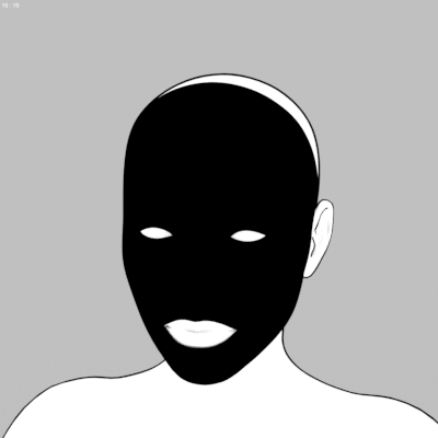

    And now the result:
    Good looking Inverted Hull in Iray
    There it is at last! A proper Inverted Hull in Iray! Granted, you have to manually input the viewpoint location whenever it changes, or perhaps just leave the camera in place and move everything else. But it works!

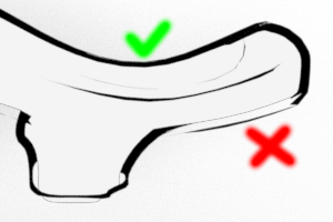

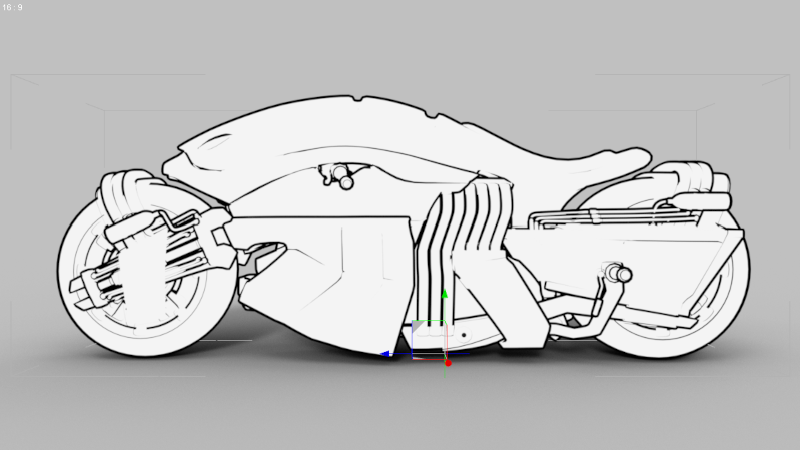

    I discovered a problem when trying to apply the method to some models, for example the Yamaki Rapture.
    When I tried to render the Inverted Hull, many parts were rendered incorrectly, as if their normals were flipped, most noticeably the surface named body_mask_top which includes the whole top part of the bike from the back of the seat to the front above the wheel.
    I thought that perhaps the UVs themselves were flipped, so I exported to Blender, flipped the UV islands corresponding to the top part of the mesh (scale -1 around X or Y axis), and imported the result into Daz as a new UV set (select object, then click Surfaces menu/Load UV Set, recreate geoshell (optional), choose new UV set in Inverted Hull shader).
    This mostly fixed the problem, but not completely. Here is annotated picture of the Inverted Hull geoshell near the seat region above the back wheel:
    Good and bad outline near the back wheel

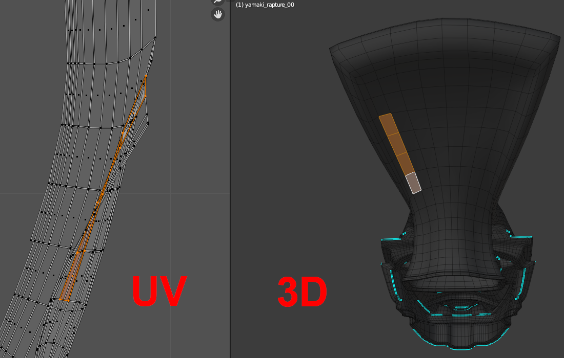

    After looking closely at the problematic parts in Blender, I saw this:
    Twisted UV quads and associated 3D geometry
    From what I understand, the way the UV quads twist on themselves makes it effectively impossible to get a consistent hull with the Tangent Texture UV method. I think that the overlapping is not a problem, but the twisting causes the Texture Tangent UV cross-product to flip. So, in order to get a good result, the UVs must be fixed.
    So I regenerated the UVs in Blender (Select All, UV/Unwrap/Smart UV Project) and imported the result again as a new UV set in Daz.
    It looks a lot better now:
    Better looking outline on the bike
    However, if you look closely, you will notice that some parts still look wrong near the front and back wheels.
    This happens because in those regions the mesh is not closed, it's just a surface that is covering what is behind. As a result, there is no back side, so no outline.
    Unfortunately, fixing this would probably require actually modifying the mesh to add the missing faces, or modeling a separate closed object that could fit over the open part and which could use its own Inverted Hull geoshell to fill in the missing outlines.

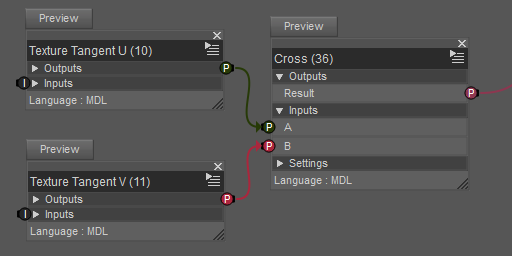

    A) Cross product brick
    I found a cross product brick! It's MDL/Default Modules/math/Cross.
    So the ugly network from before can be simplified:
    Cross brick used to compute the cross product of the two texture tangents

    Part of the shader using Uber Add Emission
    The MDL/Default Module/df/Diffuse Reflection BSDF is connected to both the [Surface Scattering] and [Backface Scattering] pins of Material - Fields. Theoretically, I should only need the backface connection because that is the visible part of the Inverted Hull. However, if I don't connect things like this (or, alternatively, add a MDL/Material Editors/Copy Surface To Backface) then I can't get the colors to show properly, especially when emission is activated.
    Also, [Thin Walled] and [Two Sided Light] are both needed to get the backface to emit without completely replacing the base color.
    It looks complicated, because it is, but it is still simpler than the alternative without Uber Add Emission:
    A different way to add emission, without Uber Add Emission
    This alternative setup makes use of MDL/Materials/Material - Structs instead of Material - Fields. I didn't use MDL/Utility/Luminance Units this time because I don't know what Uber Add Emission does internally with the values.
    The MDL/Default Module/df/Diffuse EDF brick is interesting here: unlike most of the other xDF bricks, it doesn't have any numeric* input. Instead, it is used to tell MDL/Built Ins/Types/Material Emission what kind of emission is going on (alternatives to Diffuse EDF like MDL/Default Modules/df/Spot EDF and MDL/Default Modules/df/Measured EDF do take arguments).
    * The [Handle] pin allows to enter a string value. Rather than an input, it is an identifier for Light Path Expressions, as described in Iray - Programmer's Manual. I haven't tried yet, but I may have some use for it in the near future. More info:
    - https://www.deviantart.com/linvanoak/journal/Iray-Light-Path-Expressions-in-DAZ-Studio-735776339
    - https://www.daz3d.com/forums/discussion/205886/light-path-expressions-iray
    C) More flipping issues
    When working with multiple models, or when there are multiple shells, sometimes some geoshells turn black partially or completely, usually after a refresh following a parameter change. Sometimes it's limited to the Iray preview, but sometimes it also affects the render.
    I don't quite understand why this happens, but there are a couple of workarounds:
    - if the problem is only in the preview, then temporarily changing the geoshell offset and then reverting it back seems to do the trick.
    - Sometimes it looks as if the UVs themselves get flipped internally for a set of specific surfaces (speculating here, as I really don't know what is going on). Example:
    G8F with a portion of its geoshell flipped (dark)
    When that happens, preview and render are affected. Luckily, this one can be easily fixed by toggling the switch in the Inverted Hull shader for the affected surfaces. You can see how the switch is defined in the shader in my first post, although its meaning has changed now.
    - Sometimes some parts that are dark in the preview are rendered properly, but when toggling the switch they are previewed correctly and rendered incorrectly. It's possible that the state of the switch gets lost up between the preview and the render, but I don't really know. Fortunately, restarting Daz Studio re-synchronizes the switches (or whatever is happening under the hood) so that they can be used again to fix the problem.
    I haven't tested yet, but a potential drawback of this random flipping is that it might make animations impossible without checking each frame manually. frown
    D) Going further
    Inverted Hull geoshells are fairly simple, fast and powerful, but as these images show, they have clear limitations:
    Comparative illustration of 3Delight and Iray Inverted Hull geoshells
    Inverted Hull only
    Inverted Hull only
    3Delight 3Delight render of white cylinder and cube with black Inverted Hull geoshell only 3Delight render of white G8F head and shoulders with black Inverted Hull geoshell only
    Iray Iray render of white cylinder and cube with black Inverted Hull geoshell only Iray render of white G8F head and shoulders with black Inverted Hull geoshell only

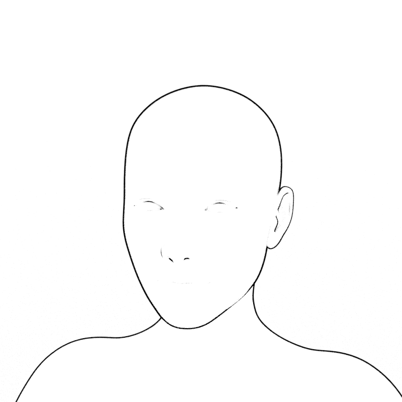

    However, it is possible to fill in some of the missing lines with complementary edge detection techniques:
    Comparative illustration of 3Delight and Iray Inverted Hull geoshells complemented with geometric and texture edges geoshells
    Inverted Hull + geometric edges
    Inverted Hull + texture edges
    3Delight 3Delight render of white cylinder and cube with black Inverted Hull and geometric edges geoshells 3Delight render of white G8F head and shoulders with black Inverted Hull geoshell and geometric edges geoshells
    Iray Iray render of white cylinder and cube with black Inverted Hull geoshell and geometric edges geoshells Iray render of white G8F head and shoulders with black Inverted Hull geoshell and geometric edges geoshells
    In this last table, the cube and cylinder are outlined using both Inverted Hull geoshell (exterior outline) and geometric edge detection geoshell (inner lines).
    I am trying to make the G8F 3Delight and Iray renders look similar, but I haven't succeeded yet. Be that as it may, both use the same method: The model (G8F Dev Load) is colored white and outlined with a black Inverted Hull geoshell, while the lips, pupils, irises and eyebrows are produced by a geoshell with a shader performing a simple edge detection on the default G8F face and eyes diffuse textures, and coloring them black (the color can be adjusted individually for each material name defined in the model).
    I think that using shaders in this way to detect edges in textures is not a good idea for performance. Better to do the edge detection externally, and display the result on a dedicated geoshell. But if you are short on texture memory or want to test the effect of a LIE modification without leaving DS, then it might be of some use.
    I will start a new thread for edge detection because it is a topic on its own. Update: link.
