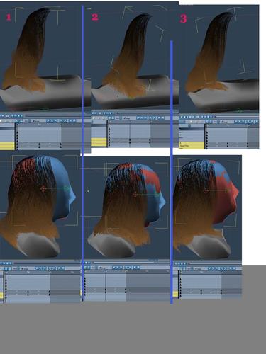

    I did a basic search this morning on Dynamic Hair - just tube stuff.. Not just Carrara..I cannot find a single video that demos dynamic hair that uses even moderate curling... They all show straight hair being tossed turned and blown in the wind.. Perhaps that is the frontier of the art right now... Hope not.
    I am still plugging away trying a work around. I have tried parenting a proxy within a proxy. What I did was put a proxy head B into a proxy head A..parented. Then I tilted the head A forwards and then backwards. To keep the hair strands vertical so as to follow gravity, I turned head B so that the strands were always vertical.
    Although this looks promising - it is still not putting the hair on an M4 figure.
    Starboardtack
    864 x 1152 - 117K
    You may be able to use some of the hair shaders, such as kink or wave to see how they behave.
