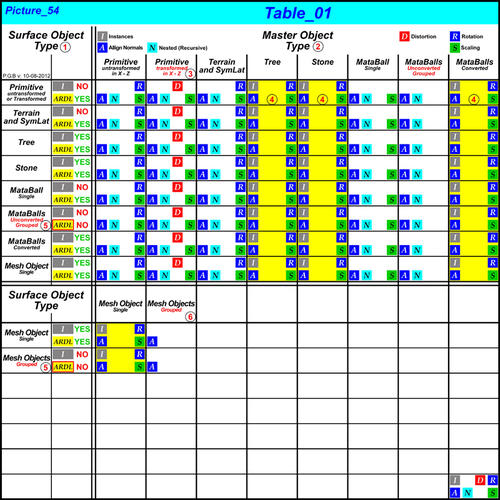

First of all i need to describe what it all means.
(1) On the left are two collumns for the "Surface Object Type". The "Surface Object Type" is the object on which another object [or objects - using a Mixed Brush] will be Replicated and Distributed and if possible True Instances created in the process.
In the second column the grey rectangle with the letter "I" in it has either "NO" or "YES" behind it. That means the Surface Object can itself be made into an instance or not [Please check under your Bryce Edit Menu when the object is selected - is the option greyed out?]. Similarly the Yellow rectangle with the letters "ARDL" in it indicates if the "I" button will appear at the bottom of the attributes stack of this object when selected. If it does not, then i indicate this with "NO". In most cases it appears except for groups [these require special treatment].
(2) On the right are many columns for the "Master Object Type". The "Master Object Type" is the Object which will be prepared for replication by you and then used in that process. It is best hidden somewhere but should not be deleted.
In the Matrix were Columns and Rows intersect there are white boxes with up to 6 little coloured squares in them. To make them easier to indentify some of the intersect-boxes are yellow [ indicated by (4) in the first row ]. These are the combinations which create instances automatically [If you don't turn off the "Instances" green radio button in the ARDL]. They are the ones we prefer if we are building mega scenes. At the top there is a legend to the left and right of the Heading which tells you what the little coloured squares mean. The grey squares with the letter "I" in them mean that True Instances can be created. They are found in all the yellow fields always at the top right.
The other coloured squares mean different things, you can discover for yourself.
(3) When Bryce CSG Primitives are transformed in X and Z so that they no longer have a square top profile bounding box [ relative to the ARDL which always works from the top view down the Y-axis ] then they behave in a strange way when turning randomly which we are by now familiar with. If we don't want this we must avoid those combinations. You should know that the primitives behave differently according to type. Cubes, Pyramids, Cylinders and Toruses will rotate in a distorted way. Cones and Spheres will not rotate at all. The red square with the letter "D" in it, warn about this. You should note that these Objects can be randomly scaled [as normal] which is indiceted by the green square with the letter "S" in it.
(5) Unconverted Grouped Metaballs and all Grouped objects in general will not allow entry into the ARDL. To overcome this select the individual objects that comprise the group. Aternatively select each sub object in the group and work on it in the ARDL. Then select the next one and so on. I will have more to say about this in future parts of this tutorial.
(6) Grouped Mesh Objects will neither randomly scale nor randomly rotate. They will however, like all objects, allign with normals [ Little blue squares with the letter "A" in them ].
There are many more interesting things revealed by this Table [which is not even complete]. I will go into all these in the next 3 parts of this tutorial. These parts will be more interesting because i intend to tackle specific projects. These although not too complicated will be less boring than the stuff you had to suffer from me up till now.
