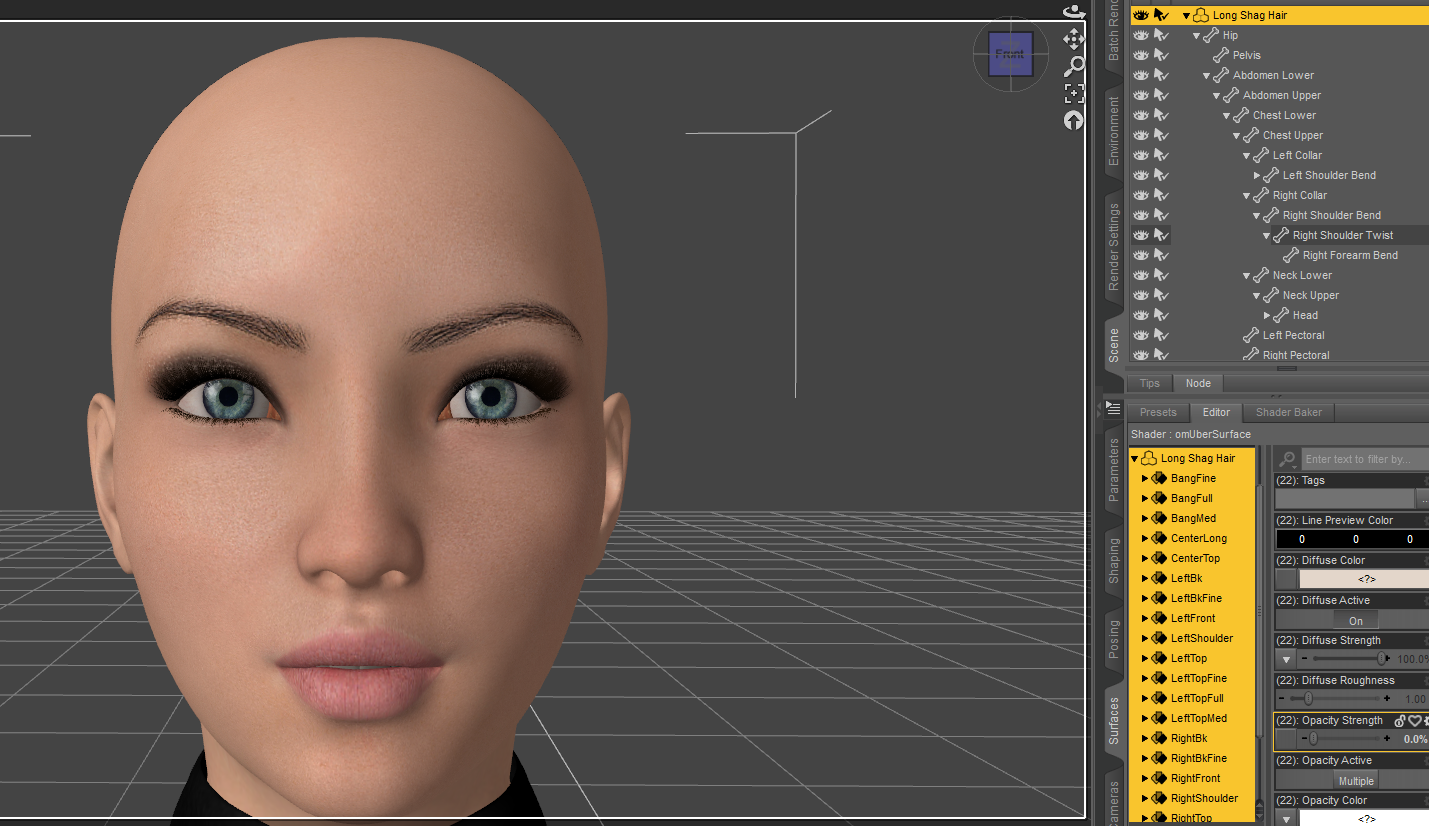

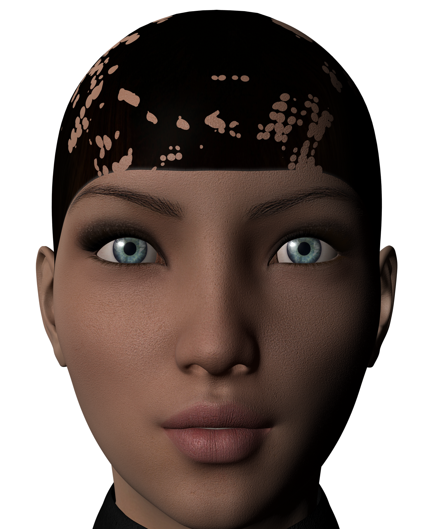

Hey, I've got a bit of an issue with the product named "Long Shag Hair" - basically when I render it, there are strange black spots poking through the top of the head (like the cap is visible but partly). This happens when I render at a base (this is 3Delight, haven't tried with Iray but anyway I'm rendering the full thing in 3Delight):

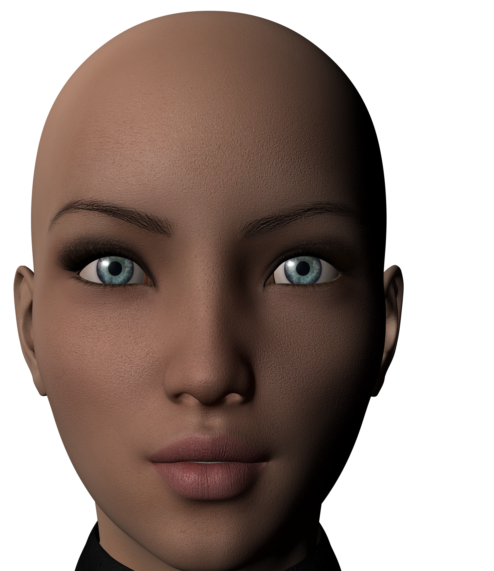

When I hide the asset, it renders without the "pokethrough", like such:
Seems normal, right?

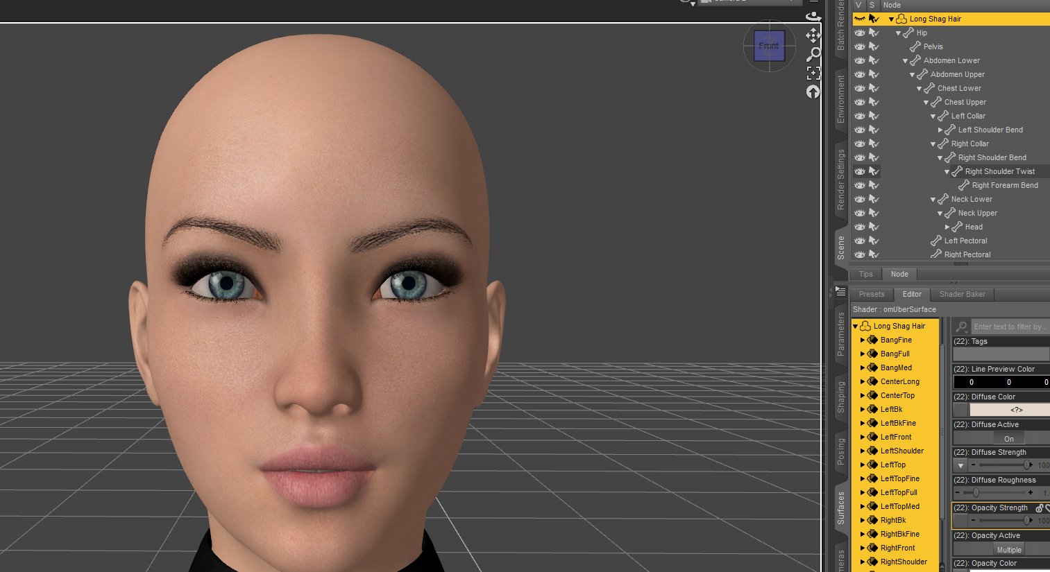

But then, this is what happens when I set the opacity on all surfaces to 0:
That's pretty strange - the cap shouldn't poke through, since it's at 0% opacity, right?

This happens when surfaces intersect each other in Iray, even if the surfaces are set to 0 opacity. Since the hair cap is not exactly the same geometry, this hgappens sometimes.
If there aren't any sliders to adjust the size of the haircap, you can create one. With the hair cap selected got o Edit / Object / Geometry / Add Push Modifier. You can name it whatever you want. It will be created by default with a value of 1, which is probably way too much. Point 1 or 2 willl likely be plenty.
