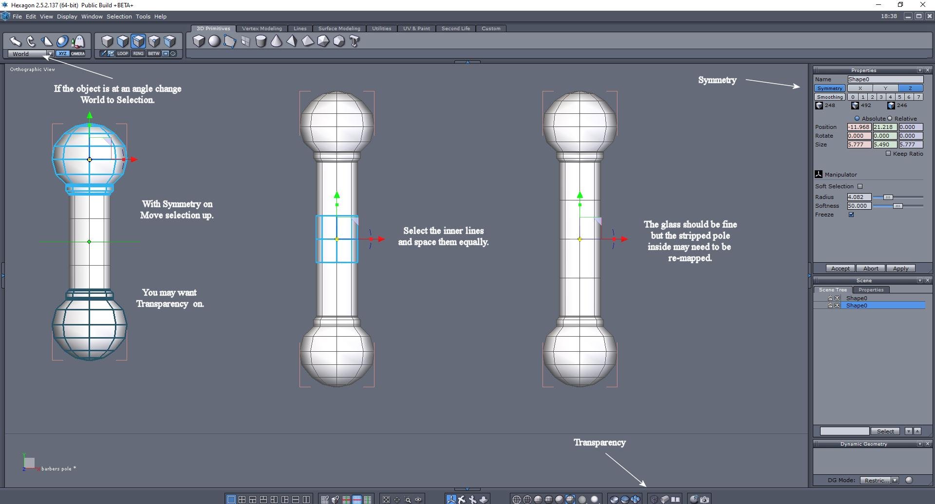

I am perplexed on what seems like it should be simple. If you make something like a barbershop pole - a long pole with caps on both ends and it is basically finished except it came out a little short - so you want to lengthen the pole between the caps. How do you do it? Most functions just effect the middle selected and do not move the top and bottom further away. I can probably delete a row of faces, move the top up, and bridge the gap ... but it feels like there should be a more elegant way to do this? In essence, I want to make the object taller without stretching the end caps. Thanks.

Did a few screen grabs, hopefully this is what you are trying to do.
I managed to do it Catherine
Thank you.
YAY! There it is. I knew there had to be a better way. Thank you very much. [Although techinically I had to manually select everything at both ends since my object is more complex and no longer symmetrical enough for automation]. Really good graphic and instructions by the way.
Thank you, glad you got it sorted.
