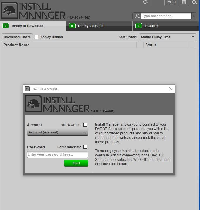

    DIM has forgotten about me.
    DIM suddenly stopped remembering my account.  Do I add myself?  If I do, will it remember what is already installed?  Hesitant to experiment.

  • DiomedeDiomede Posts: 15,454
    Well, I added my existing account as a new account.  DIM does not recognize any of the old downloads.  Windows just had an update.  My default after a Windows update is to blame them for every bad file-related thing that heppens shortly thereafter.
    You would have to look under the gear icon (upper right) and the Advanced menu to see if it's still pointing to all the correct folders.
    AllenArt said:
    Argh.
    Thank you.  No.  No it is not pointing to all the correct folders.  It does not recognize any of the downloads that have already been downloaded.  I had created custom installation folders.  It does not recognize any of those.  I had installed Hexagon.  It does not have the Hexagon as one of the applications.
    Argh.
  • The account details and settings are in a .ini file in
    %AppData%/daz 3d/installmanager/useraccounts/
    See if you have a back up of a slightly older version of the file, in case it is damaged.
    Diomede said:
    RE: Windows - Completely slander on my part.  All my programs worked fine.  Windows gave the Update flag, which I kept ignoring.  I left my PC to run an errand and Windows had updated my computer while I was gone.  Now DIM can't find my manifest file, or whatever.  I don't know it was Windows.  But, it is the only thing that I can confirm changed for the moment.  And, it is the kind of thing that has been screwed up after Windows updates in the past - again, without me confirming that the true cause is Windows.
    I have done disc searches for ini files.  Found some for a few programs, including Daz postgrl, but nothing for Install Manager.  So, I will just have to figure out what the least annoying response should be.  On the one hand, everything is installed.  And, I know which order has not been installed.  Annoyance and pain no matter how I respond.
    Argh.
    In any case, thank you both for your helpful suggestions.
    Argh.
    If Windows restarted it may not have allowed the file to finish updating on exit or the like, corrupting (or even deleting) it. Did you look in the exact path I gave? Just paste it into a file browser's addess bar and it will expand the %AppData% part into the correct path to get to the real folder.
    Unfortunately, that just brings me to the new ini file without any record of what has been installed or my custom folders.
  • Yes, if the good file was still there then you wouldn't have had the issue - I was asking if you could roll the file back to an older, hopefully still good, version from a back up or system snap shot.
    Aha.  For whatever reason, I wasn't thinking of looking for a single file that way; had fooled myself that the big backup was for big crashes.  blush
    Will dive back in.
    Thanks again.
