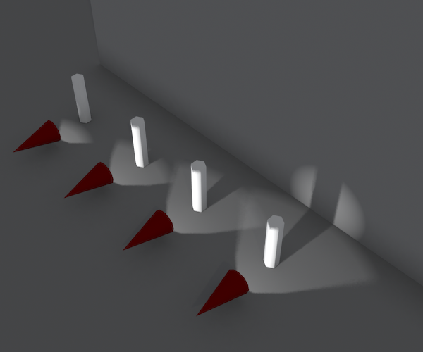

    It sounds like you need the "falloff" parameter, which the standard spotlights don't have but the ones Jimmy mentioned do.
    However the Linear Point lights have falloff controls.
    I made some spots by putting the linear point lights in a cone and set various falloffs...
    600 x 500 - 250K

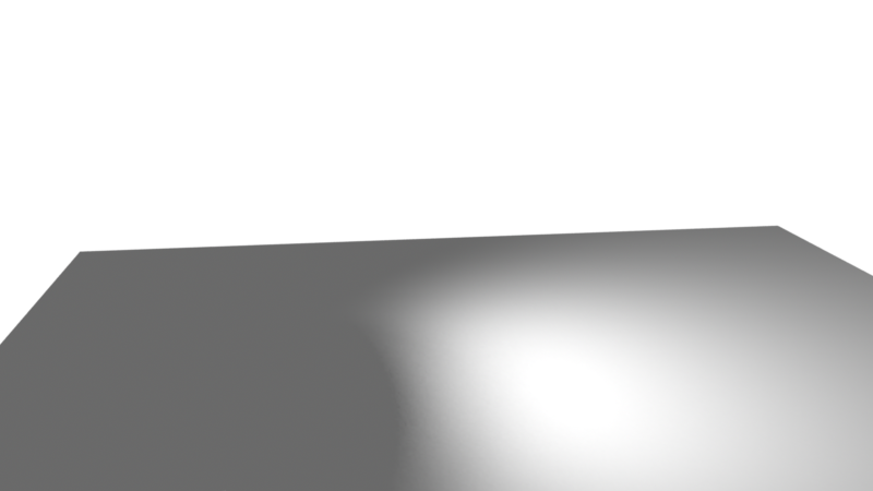

    Scavenger said:
    I just tried a quick experiment with that... Fantom seems to seems to do similar to "Not Visible in Render", so the plane I set between the spotlight and object didn't render, and light passed thru it, to the object, casting a shadow of the object....
    That's actually the opposite of what I want. I want the plane to stop light from going past it, but to not be visible either. Basiclly a "the spotlight can not go beyond this point" thing...an invisible Gandalf saying Thou shall not pass!
    In order for there to be a shadow the light needs to be set to cast one. The object needs to remain 'visible' in the viewport as well. Hiding it will also hide it from being able to cast shadows.
    Here's a quick example of the UberSurface Fantom setting in action. The cylinder is set to use the Fantom setting and the light is cast at a slight downward angle.
    1125 x 867 - 108K
    1200 x 1000 - 1M
  • Scott LivingstonScott Livingston Posts: 4,352
    As HOF said, using a plane with Fantom turned on should do the trick...make sure Raytrace is also enabled, and set the light to Raytraced shadows. However, I agree with prixat that using a light with falloff would be a better, more realistic way to achieve what you want.
    Works fine with Shadow Map shadows as well, but raytraced will always give the best results in either case.

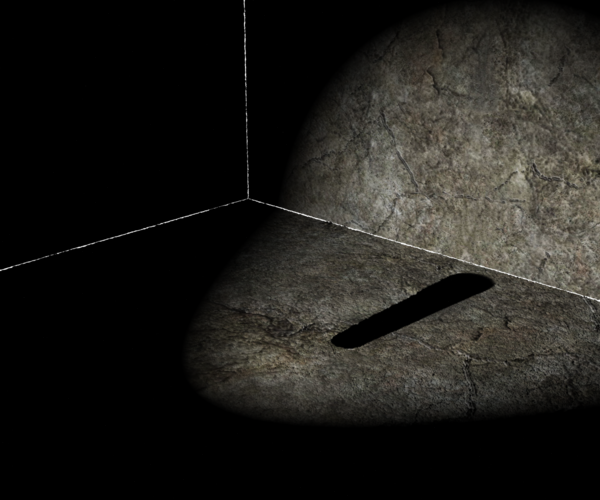

    Richard Haseltine said:
    Is this Iray? Light path expressions are not terribly user-friendly but they do allow you to limit a light's effect to only certain objects (see the Canvases sub-tab in the Advanced tab of Render Settings). In 3Delight the Advanced Spotlight does have barn door settings, I don't think there is an Iray light like that.
    Umm, to my best knowledge the AoA lights have no barndoors, only normal light spread and support for gobos.
    So to block out light barndoor style you need to use primitives just as descriibed earlier in this thread.
    Quick example using an AoA spot and a primitive with UberSurface applied and Fantom active:
    748 x 561 - 94K
    419 x 647 - 74K
    800 x 450 - 150K
    Post edited by Sven Dullah on
